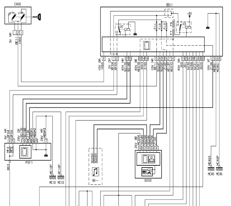

Ok, so looking at the wiring, I would check the earths. It looks like the earths (MC301 & MC302) from the front and central interior lights (3010 & 3030) and check the 40 pin white plug in the BSI that wires 300 & 301 go to.
I would also check to see that there is power going through the fuse F7.
Click to zoom the diagrams
