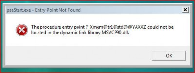

Re: Update Diagbox version
No go.... same error.
I got this:
I managed to fix that by installing updated C++ runtime library. However, when it runs the psastart file at boot, it fails, and gives an error that psaagent has failed to start. When I open DiagBox I get the same error. It says the fault is in a file msvcr90.dll - which also appears to be something to do with C++ - however despite installing the later versions of C++ runtime, and copying that file to everywhere I could find an earlier version, it still won't run
I searched for the file in the registry but it's not mentioned any where. I then tried to re-install the doc back up, but that gives me an error on the software being out of date and it won't open. I've had that before, but a restart fixed it - not this time.
Can someone search for the that DLL and see where it is located?
Otherwise I think I'm going to have to re-install windows patch up the C++ to the latest (although the 2015 version won't currently install), and then see if DiagBox will install on a clean version. If that won't work, then I'll have to go looking for a later version of Windoze....

Totally crocked it now I think - can't get the 7.57 updater to run now. I think a re-install of the OS is required.
