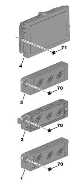

GiveMeABreak wrote: 27 Mar 2018, 10:51 Hi and welcome.
I think your problem may be with the multifunction screen. There are 4 types of screen - 3 of them look identical - but the RD45 needs a particular one which is different to the one fitted with the RD4 standard unit. The correct one will depend on your DAM and options. If you have your VIN, I might be able to work out the right screen for you from the options. You will need either 1, 2 or 3. Obviously you already have one of these - so it may be one of the remaining 2. It is also referred to as EMF 'C' type screen.

I very much doubt that that any display from before 2010 is bluetooth compatible.
You need to check that the software is higher than V.71
Also you need to get a screen that does not have the heating / AC controls on the screen.
