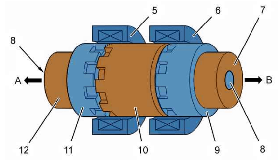

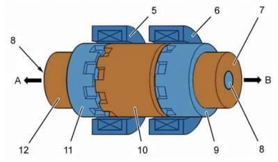

Torque Sensor
The torque sensor is inserted on the steering shaft between the input shaft (steering wheel side) and the output shaft (rack pinion side).
It permits continuous measuring of the torque applied to the steering wheel by the driver.
ReferenceDescription
ARack pinion side
BSteering wheel side
5Measuring coil fixed in relation to the steering column
6Reference coil fixed in relation to the steering column
7Input shaft on the steering wheel side (B)
8Torsion bar linking the input shaft (7) and the output shaft (12), allowing a relative movement between the two shafts of +/- 4,5°
9Detection ring solid with the input shaft (7) (steering wheel side)
10Detection ring solid with the input shaft (7) (steering wheel side)
11Detection ring solid with the output shaft (12) (rack pinion side)
12Output shaft on the rack pinion side (A)

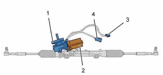

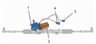

Steering Rack
1 - Torque sensor signal
2 - Assistance motor
3 - Assistance motor supply connector
4 - Torque sensor signal connector

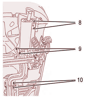

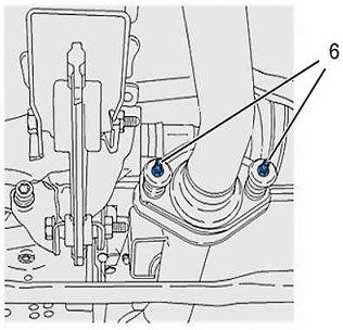

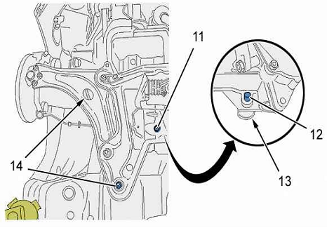

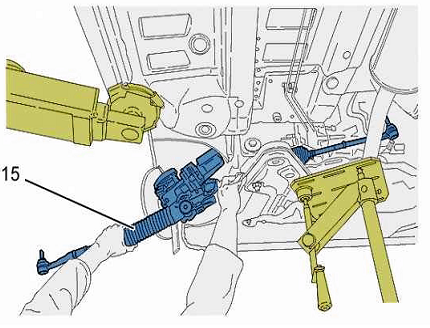

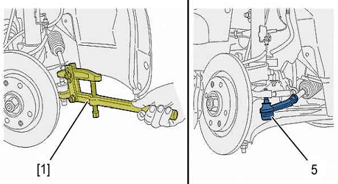

C2 Rack Removal
Disconnect & Remove Battery
Preliminary operation
Note: Systematically replace the seal

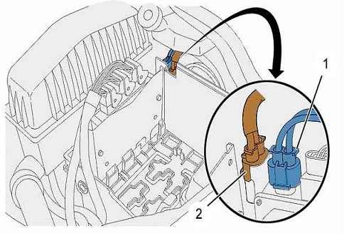

Disconnect: The connectors (2) & (1)
Lift and support the vehicle with front wheels suspended.CAUTION: Place the front wheels in the straight on position. Lock the steering wheel in this position.
Remove the bolt (3). Disengage the steering cardan joint by pulling on part "" of the steering column (at "a"). Remove the front road wheels.
Remove nuts (4) (Right and left side).

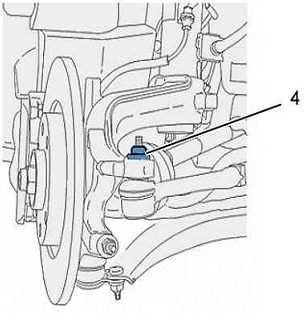

Extract the steering ball-joints (5); Using tool [1] (Right and left side).
Petrol engines - Remove screws (6).

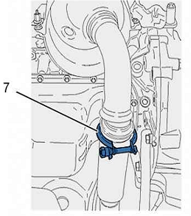

Diesel engines - Remove clip (7).

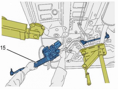

Remove the nuts (8), (9) and (10). Fit the exhaust line on the rear crossmember.

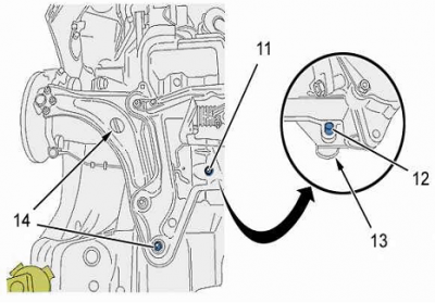

Remove: The nuts (11), The studs (12) (TORX recess), N.B.: Recover the toothed washers (13). Support the front subframe with a lifting tool. Remove screws (14). Lower the cradle (petrol engine, until contact with the exhaust line).
Remove the steering mechanism (15) via the wheelarch.
CAUTION: Do not carry the steering mechanism by the electric motor. Store the steering mechanism in a box.

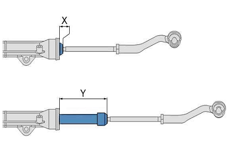

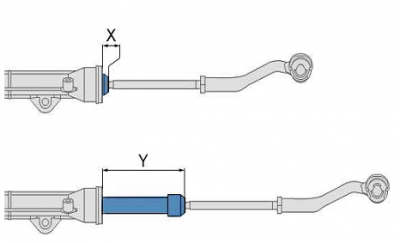

Timing - Straight-On Position of Steering Rack
Preliminary operation - Raise and support the vehicle on a 2 -post lift.
Remove ( right hand side): The clips (1) & (2)
Remove the steering rack protection gaiter.
Timing
Turn the steering wheel to left hand full lock.
Measure dimension X.
Turn the steering wheel to right hand full lock.
Measure dimension Y.
Calculate the dimension L = (Y - X) : 2.
Position the steering rack to dimension " L" (mid point of the rack).

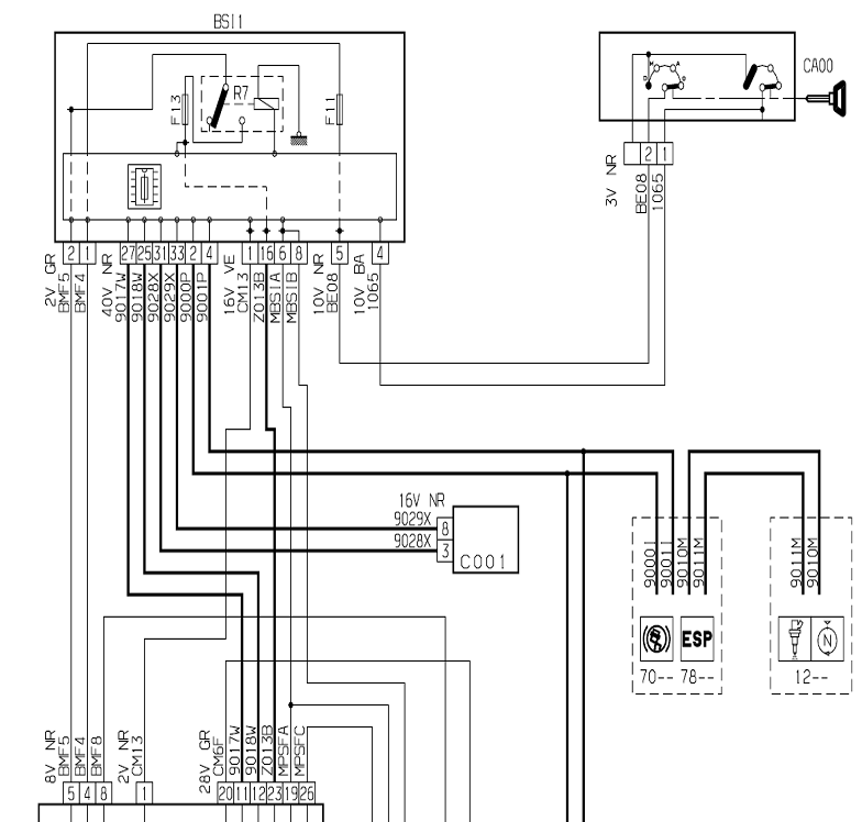

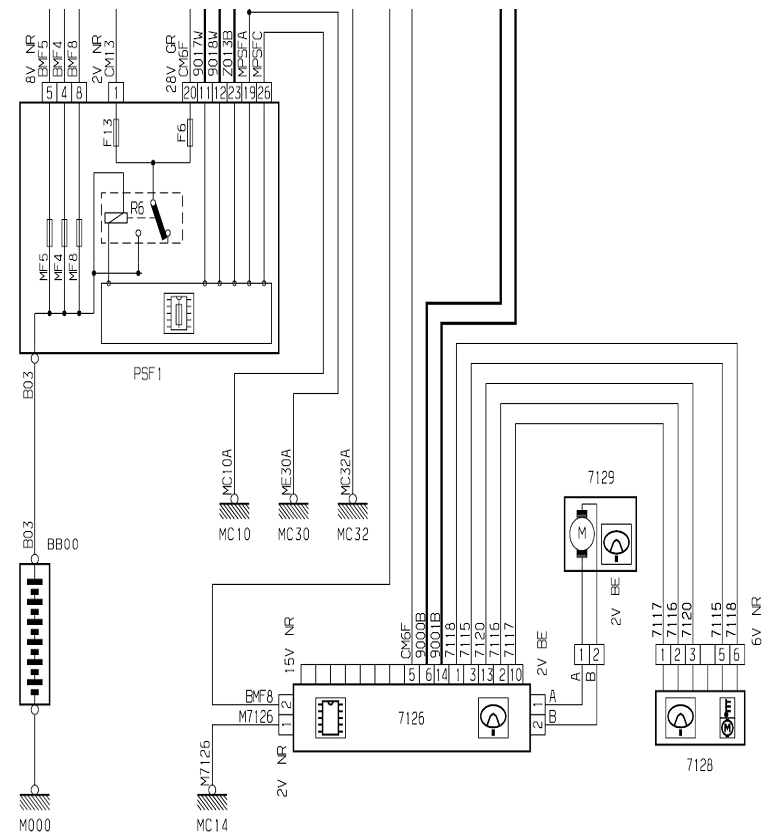

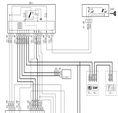

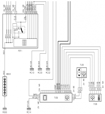

Didn’t know you wanted a wiring diagram Iain, I have a few requests for info on the go right this minute, so will try and get you the wiring diagram shortly.
x 6945
Re: Anyone know anything about C2 // C3 racks?
Iain, - Diagram for PS - in 2 Halves and Key below.
Click to Zoom
Lower Half
Lower Half
Upper Half
Upper Half
Key:
WiringHardware
7118: Secondary torque info7126: electric power steering ECU /
7115: Torque sensor power supply7128: electric power steering torque sensor
7120: Torque sensor temperature info7129: electric power steering motor
7116: Torque sensor earth-
7117: Primary torque info-
9001B: Low Intersystem / Can bus-
9000B: High Intersystem / Can bus-
CM6F: (APC+, Earth)-
