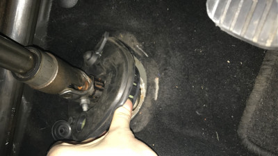

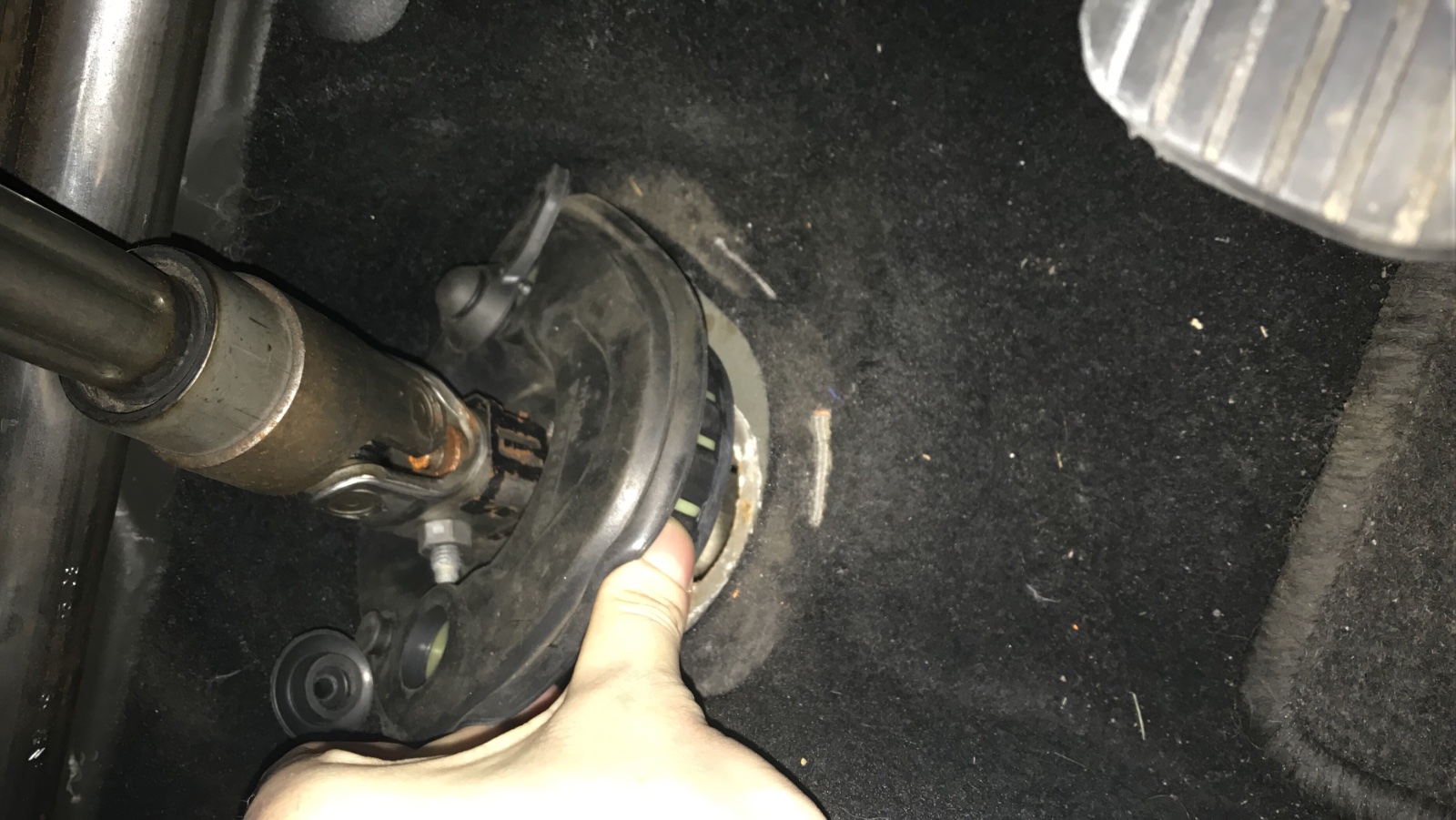

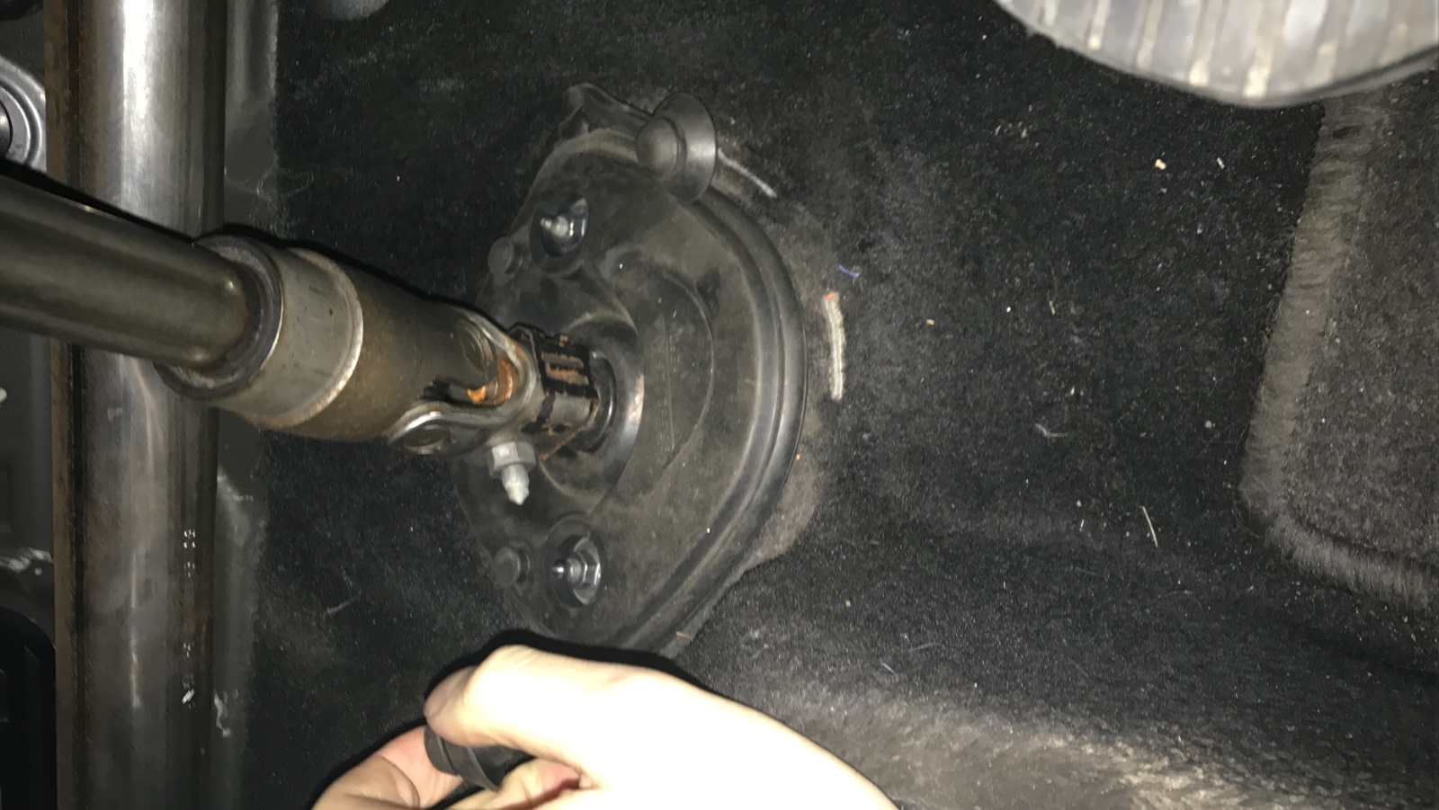

Just been to investigate now as I'm curious about the condition of my '58' X7.
Please don't tell me you need to disconnect the steering linkage to see properly?
The rubber seal doesn't want to lift up any higher, more force required?

Re: X7 steering rack damage prevention
Yes, you need to undo the shaft, but it's only the 10mm(?) pinch bolt, slip off the catch, and the shaft should slide upwards. Don't turn the shaft unnecessarily so that you 'unwind' the steering wheel and its internal wiring.
