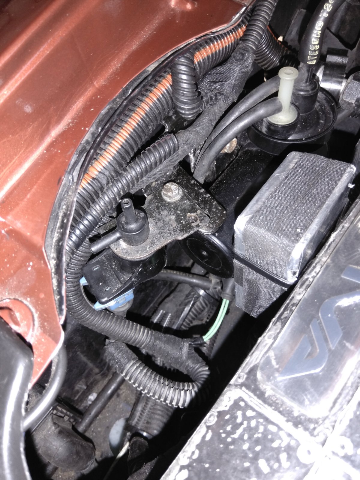

Alasdair and I did a bit of work fitting cruise to his Activa... The car had half the cruise loom installed - the dash/cabin half - but no engine bay.
This enabled Alasdair to locate the vacuum pump into a new an very sensible place next to the ECU box

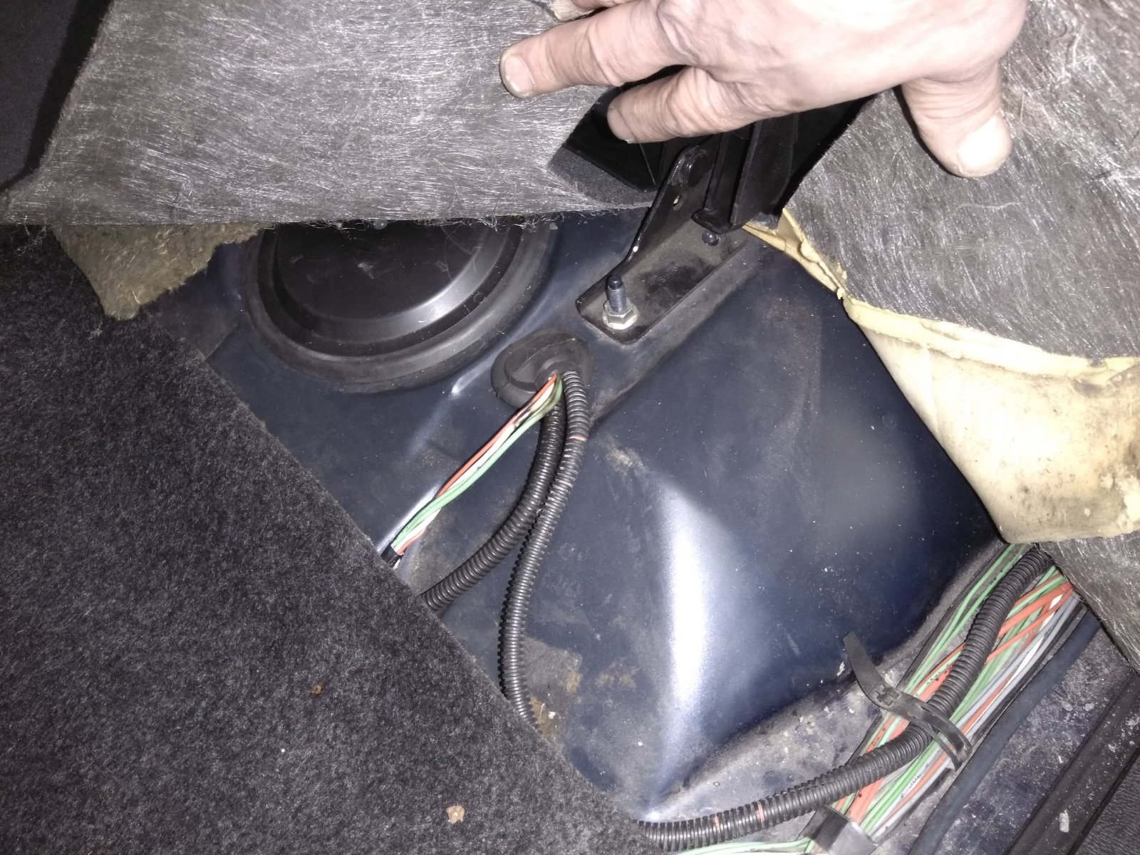

This made an issue to get the wiring for it back to the Cruse ECU socket under the front passenger seat...
After trying to get it in the A pillar grommet where the door loom enters we gave up and scratched our heads... We hit on the idea of running the loom along the conduit under the car shared with the fuel lines and fuel pump/gauge wiring.. This worked a treat
Here the loom comes up through the fuel pump/gauge wiring grommet under the back seat...
This is an excellent route to bring cables from the engine bay into the cabin

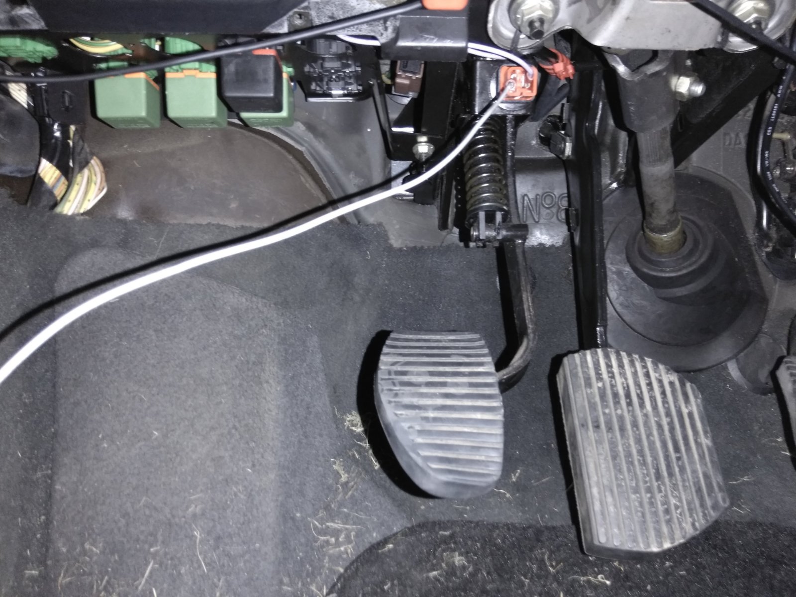

Then the brake and clutch switches... The brake pedal had no cruise contacts but Alasdair found an automatic brake pedal mounted on its side worked a treat and needed no mods to fit to the pendant...
We also found the LHD V6 has no spring between the pedal pendant and the dosuer! Just a solid rod. We also discovered Alasdair's dosuer is weeping LHM too
Another job but easy on an LHD once the LHM reservoir is removed...

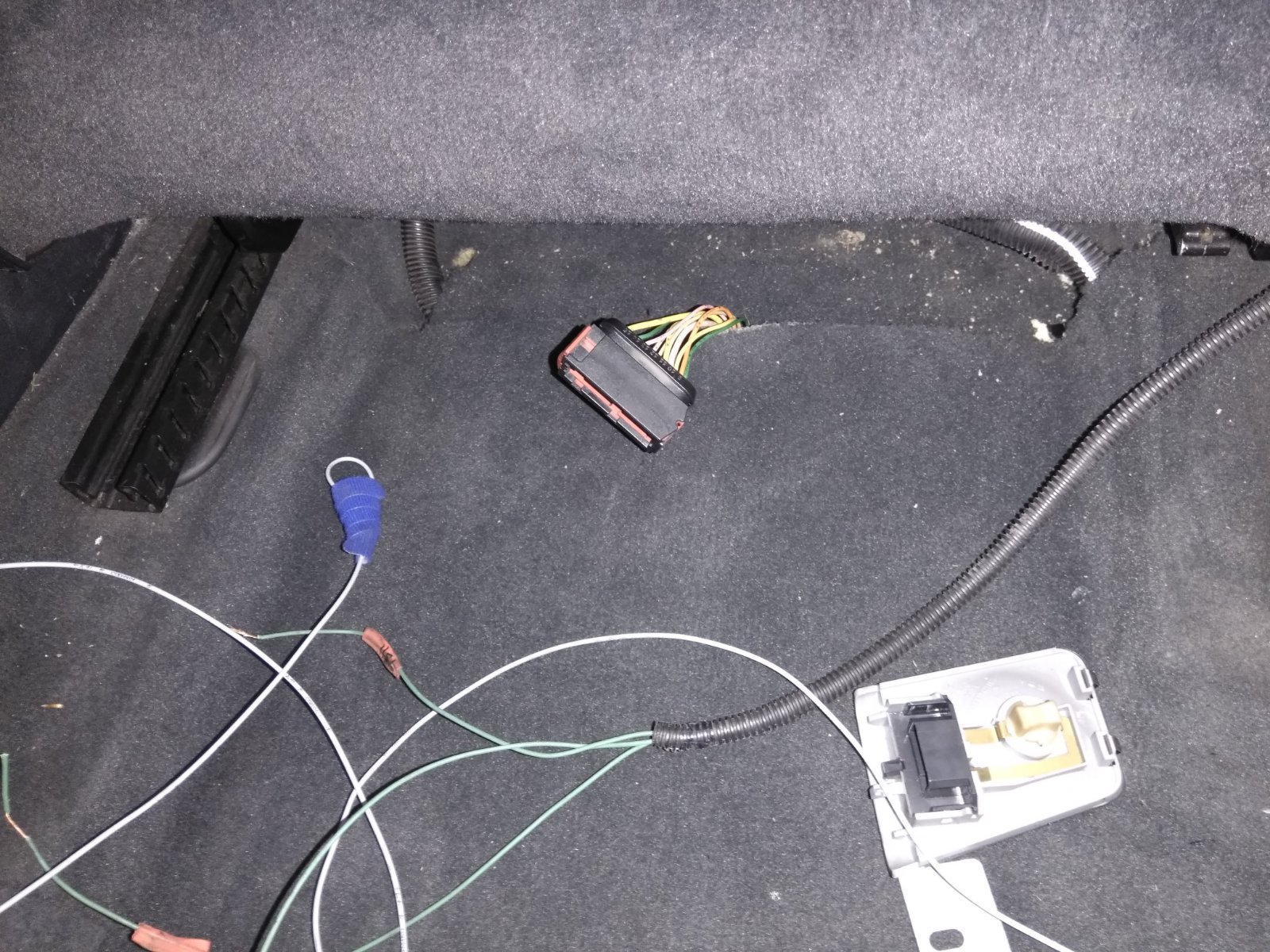

The clutch switch was fitted and wiring added... This loose wire in the picture is to route back to the ECU socket and carries the clutch and brake signals...

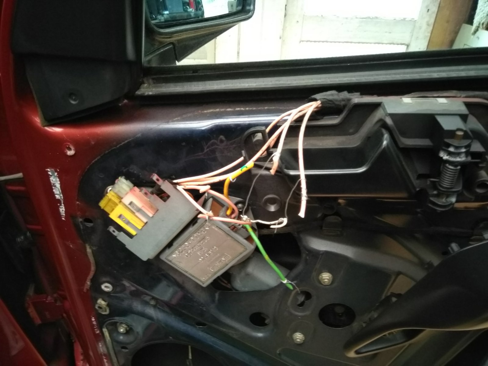

Finally we set about fitting the one-touch electric window ECU to the passenger's side... We determined the wiring modifications and then it was time for me to go before I got snowed in...

"One Touch" window mode works ....good job Jim
Now to run the brake/clutch cut off wire and finish cutting into the cruse loom, put back the carpets/instruments/binnacle/steering wheel/switches and all the other stuff I have ripped out looking for connectors and gaining access!
I stand here shaking at the words that emanated from my footwell yesterday.... shocking in twas !
