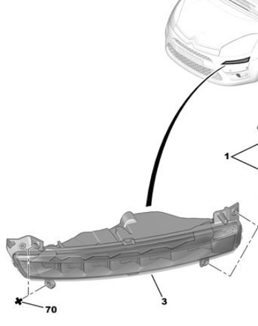

Ok, now I've been able to check your vehicle, they upgraded the light below from the flasher only unit (which is what you have) with a DRL unit from 26 May 2010. So you'll either have to keep switching on the sidelamps manually, or get the BSI configured for permanent headlamps (and sidelights) on with ignition.
I can't tell you whether your BSI will allow sidelamps only on for the scandinavian country setting, or whether it will be headlamps and sidelamps with this option enabled....
