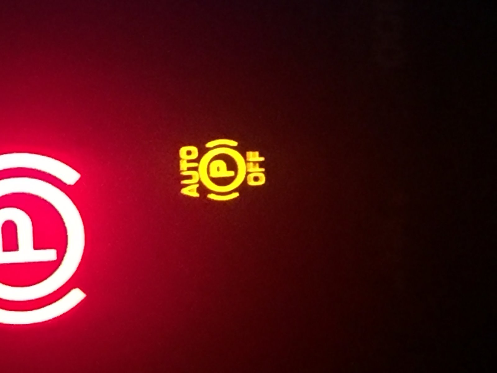

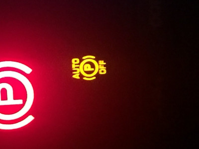

I have had this light on for several months but no faults have been thrown up can anyone advise please?
I think it has something to do with the auto handbrake but I am not sure.
I have gone through the setting on the steering wheel and changed the option to on or off but he light stays on and nothing changes.
The car drives as normal I have to manually deactivate the hand brake as I think it should come off auto when I drive off but again I am not sure?

This refers to the Electric Parking Brake.
If it is on, then is means one of two things -
A) The automatic application and release functions have been disabled (via the Menu: “Personalisation/Configuration /Define the Vehicle parameters / Driving assistance / Automatic handbrake”. In this case you must apply and release the brake manually, including when the engine stops.
B) The same applies as above - but the Automatic Function is faulty.
You can check the status by going into the menu for the car options as I described in (A). It is sometimes recommended to deactivate the automatic function when it is very cold / snow / ice and towing of course).

Ok, so if you are sure it has not manually be deactivated, I'll have a look and see what conditions cause the backupmode to engage. Do you have your VIN handy, so I can check the exact options for your car? PM me if you don't want to post it here.

Regarding the LED - if this is remaining lit without the SERVICE light or the 'P' warning lamp, then it can be caused by many issues. The system has gone into a 'Backup Mode' and will remain like this until it is sorted.
The only way to resolve this is to get the fault codes from a Diagbox / Lexia session. There are too many faults that can be returned to start guessing, but it can be caused by an electrical coherence fault, or by the number of application cycles of the handbrake. It may be simply a matter of undertaking a calibration procedure to fix - but we really need the codes to be able to progress and point you in the right direction.
The system is designed for 100,000 application cycles - but there could be many causes, so getting the actual code is a priority - and will no doubt need to be sorted prior to an MOT.

The word SERVICE is lit also, but I will see what I can get sorted this week.

Hi John, no worries - the codes are numerous and the actual combination of the 'P', 'SERVICE' & 'Auto PBL' LEDs can again have many meanings - so that is helpful, along with the fault codes you can obtain. Let us know and I'll see what comes up.
