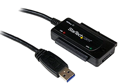

IDE to USB Card Reader
You will need some form of USB to IDE converter in order to copy the data from the original Hard Drive to an image file and again to write the image back to the CF Card.
USB to IDE Converter
I already had one of these from Startech that are reasonably priced. They are available in USB 2.0 or 3.0 specifications - but be advised that my USB 3.0 version failed to write back to the CF Card when connected directly to the IDE adapter and when connected to the USB 3.0 Port. In the end, I used the Compact Flash Internal PC Card Reader I have and this worked fine, albeit at a sustained 2.8MB/s write speed. I was happy with this as at least the data was copied back correctly without incident.
This is probably down to the USB 3.0 speeds being too fast for the CF card to handle as you have to remember that the USB 3.0 SATA / IDE converter is designed to send through data at the fastest speed available and also that the CF IDE Adapter is passive. It should be fine with USB 2.0 though.

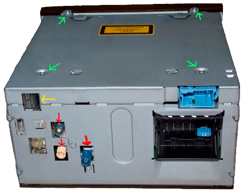

4) Remove the connectors
A word of caution. It is very important that the LVDS screen connector at the rear of the unit arrowed in yellow in the picture below is not disconnected when the unit is powered, as this can cause failure of the multifunction screen! This is a Citroen documented warning.
  • Always remove the 40 way Quad Lock connector (the large black one) first as this carries the power. It has a swing over locking mechanism that must be moved gently and this will release the connector.
  • The same locking mechanism applies to the pale blue connector above.
  • The LVDS connector can be carefully wiggled out and has no other securing latch.
  • The GPS / GSM and Aerial Antennae arrowed in red, are locked in place by a small plastic lug at the top. Use a small flat blade screwdriver to gently press down on this while gently pulling the connector away.
  • The USB and other connectors should be easily removable.

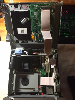

6) Next, you need to remove the 4 torx screws on the top of the unit indicated with green arrows.
7) The whole of the top of the unit is basically loosely hinged at the rear (connector end). You must be extremely careful here, as immediately attached to the inside of the lid is the DVD player and the ribbon cables, so do not go poking about inside with any instrument.
8) Using a small flat bladed screwdriver or blunt instrument, you need to gently lift the top of the unit working from the front of the sides, working towards the back on each side. Use a gentle pressure to lift the unit lid up, but do not use too much force as it may suddenly release and you may pull or damage the ribbon cables.
NG4 DVD Unit and Lid hinged Open
9) Be aware that the unit is not secured at the hinge - it can easily lift off so be extremely careful not to leave the unit unsupported as there is a lot of weight on the top of the lid. Also be very careful not to put any strain on the ribbon connector.
10) Undo the small torx screw on the left hand side, and use a small flat blade screwdriver to lower the metal flap. You can now slide the hard drive enclosure out of the unit.
11) Remove the 4 screws securing the drive to the enclosure - be aware that there is some ‘thread lock’ type adhesive on these - so they will be quite tight - also make sure that your torx bit is the right size to prevent damage to the head.
12) Gently lower the Lid back down and put the NG4 unit safely to one side.

Connect your Hard Drive to your IDE to USB converter first before powering up the converter (if applicable) and then connect the converter to your USB port.
14) Launch HDD Guru, which should detect all the PC Hard Drives as well as the NG4 Toshiba. You can check the correct drive by looking at the Serial Number on the HDD and matching this with the serial number shown in HDD Guru.
15) You first select the Toshiba as the source drive from the list, then you select the target location. In this case as we want to keep a source image of the drive, so select a target location on one of you PC Hard Drives that has at least 40GB free space. The tool makes a compressed image of the drive which in this case will result in roughly 24GB on completion.
16) Once the image has been copied and there are no errors reported, you can prepare to copy the image back over to the CF Card.
If using an IDE to USB converter:
17) If the CF to IDE adapter card has any jumper settings to configure, ensure the CF card is configured as ‘Slave’, as the NG4’s DVD Drive is the ‘Master’.
18) Ensure the USB connection of your IDE to USB converter device is removed from the PC. Insert the CF card into the CF to IDE adapter and in turn, connect the adapter to the IDE to USB converter device. Ensure that the pins are lined up properly then connect to the USB 2.0 port of your PC.

20) Once completed and assuming there were no errors, power off and remove the CF Card Adapter or eject the CF Card from the Reader.
21) Depending on the type of CF to IDE adapter you have, you may need to support it once it is plugged into the NG4’s PATA connector. Although these adapter cards are quite light, you do not want any vibration bouncing the card up and down, weakening the pins. Also, depending on your adapter, you must not allow any part of the underside of the pins or solder joints to come into contact with the drive enclosure metal. I used some ‘coin’ type adhesive foam pads and positioned a few of these under the card to act as both a cushion and an insulator. These worked great in keeping the adapter card level.
This picture shows one of the foam pads in place - I used 2 in all.
Placing Several Coin Pads to Cushion IDE Converter
Placing a Foam 'Coin Pad' under the CF Adapter
22) Now carefully position the CF Card adapter into position and connect the pins ensuring they line up correctly. Check that there is no excess play and that the adapter is well supported.
CF Card and IDE Adapter Installed
23) Secure the drive bay rail flap and replace the screw. Carefully close the lid ensuring you don’t trap the ribbon cable. I would suggest securing with one screw, just to keep the lid shut, until you connect the unit back up and check the system, in case you need to remove it again.
