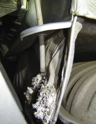

Re: Passenger Compartment Batteries
I think it is perfectly valid Paul - vented batteries need to be vented outside the vehicle - but even some 'sealed' batteries give off fumes.
Take these pics of BMW showing the venting - and what it can do when not vented out properly.
Although I appreciate the Xsara Picasso has a vent pipe - I personally don't like the idea.
