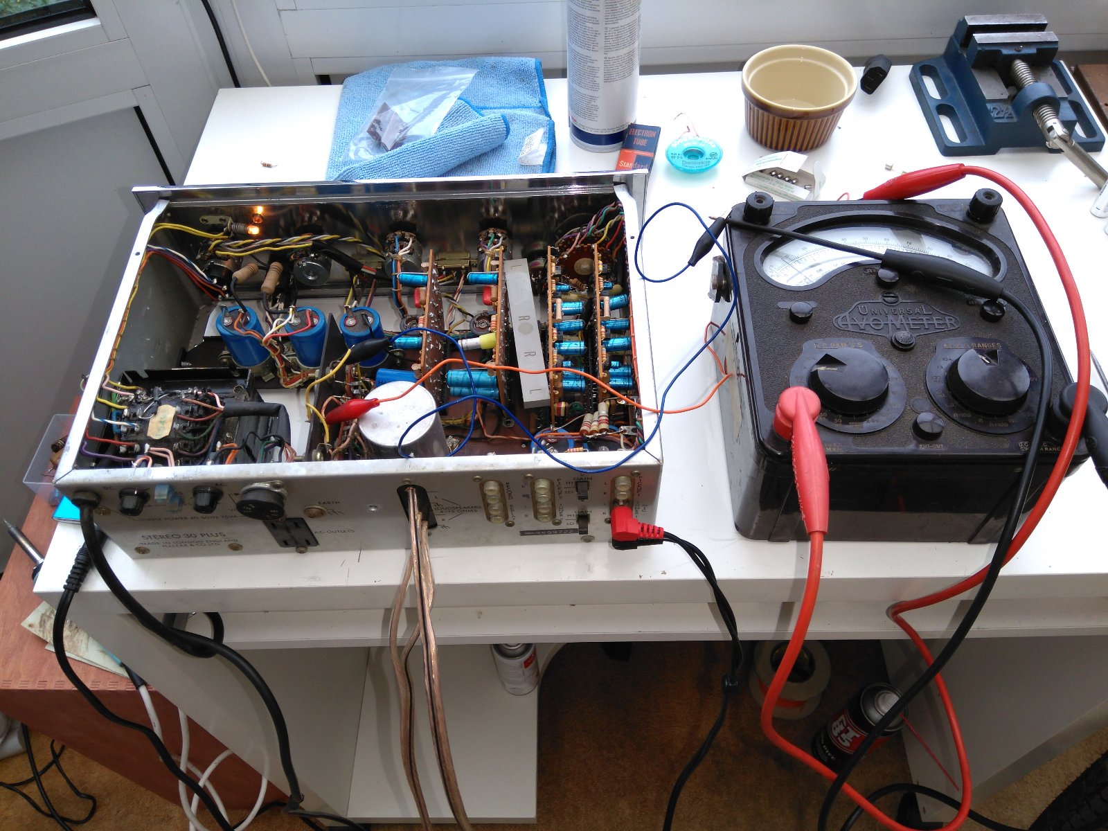

No car work lately. Weather has been rubbish today so it's been a day for fixing vintage stereo amps...
First up, this lovely late 60s Rogers...
Own work
Own work
The problem was traced to a small resistor of a sort that hardly ever fails but it did in this one!
It sounds awesome

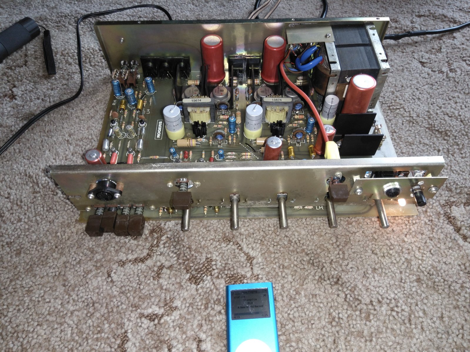

The second is a Leak of a similar age that was blowing fuses. A set-up of the output stage bias appears to have sorted it... Now on a long test...
Own work
Own work
Neither are mine - I'm fixing them for a friend...

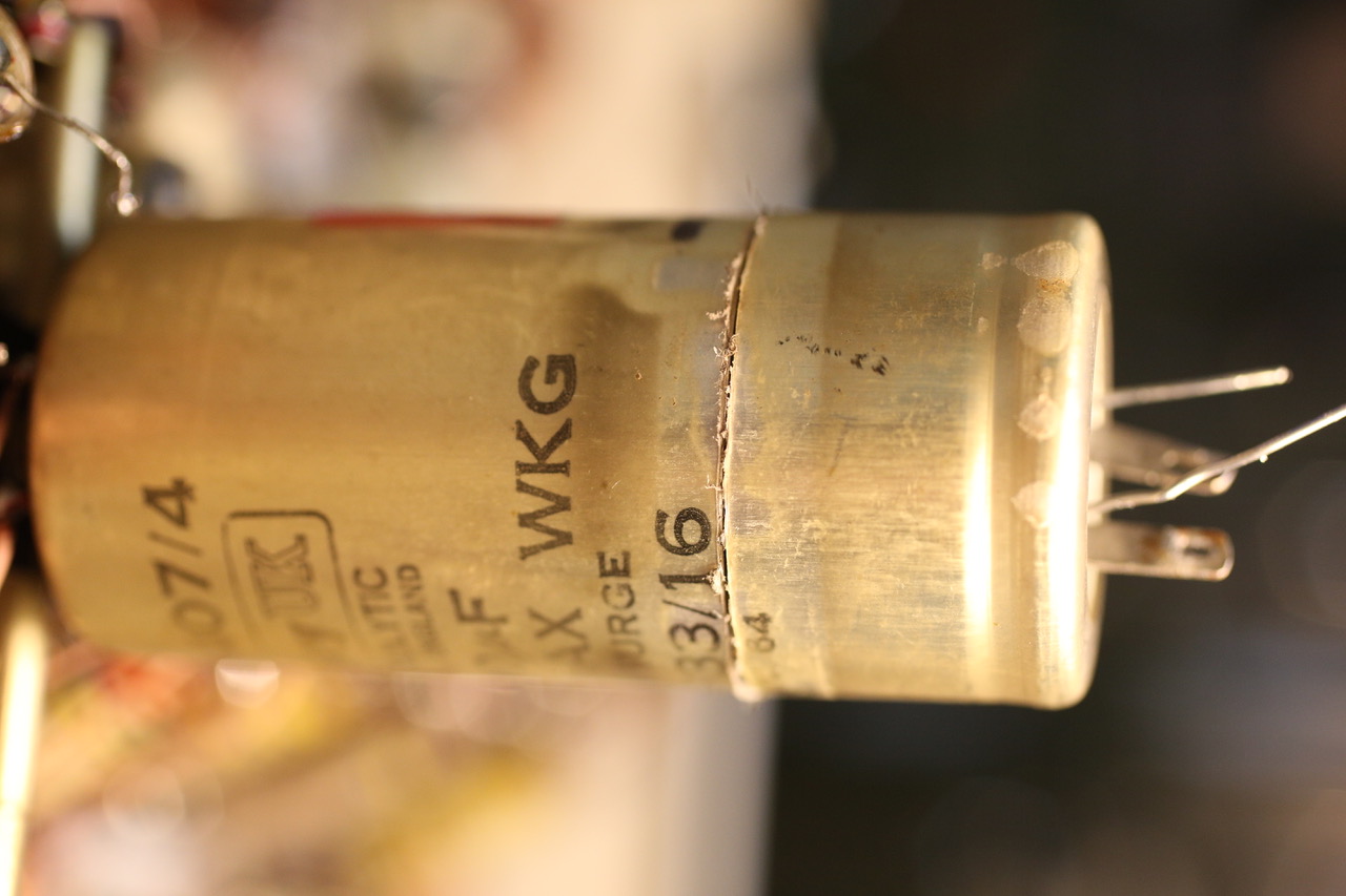

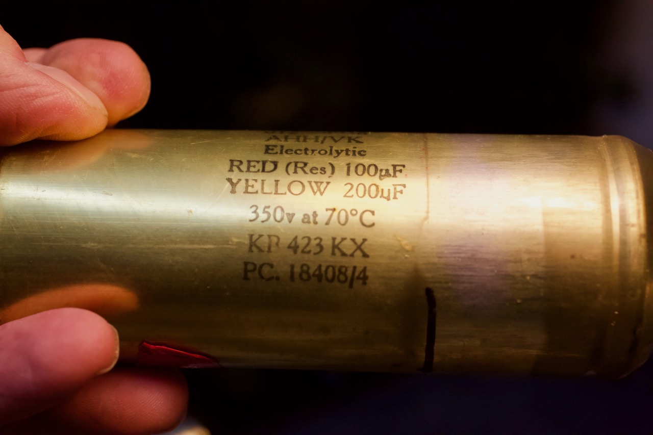

Jim - you might appreciate what a mate of mine has been working on. He's slowly bringing a huge old Army radio set back to life (you might even have heard of it :wink: ). He tried to reform the caps in it - they were last reformed in 1964 !! but they all failed, so next best option was to replace them with identical ones to keep it authentic.... but he couldn't get any. When you see the size of them, that's not surprising...
Big cap
Big cap
...so next best option was to cut them in half, hollow them out, and put new ones inside with the tails coming out the original tag rivet locations...
Hollow cap
Hollow cap
Cap tails
Cap tails
Finished cap
Finished cap
The cuts will be hidden by the clamps that holds the caps in place.

bobins wrote: 10 Feb 2018, 20:46 Jim - you might appreciate what a mate of mine has been working on. He's slowly bringing a huge old Army radio set back to life (you might even have heard of it :wink: ). He tried to reform the caps in it - they were last reformed in 1964 !! but they all failed, so next best option was to replace them with identical ones to keep it authentic.... but he couldn't get any. When you see the size of them, that's not surprising...
Wonderful :D 8-) =D> That's right up my street! Keep me appraised of progress please ;)
Doing that with duff components to maintain looks is what we call 'restuffing' :) I've done it many times with big can electrolytic. Some even restuff wax capacitors and resistors!
Just make sure the small replacement electrolytics are up to the job with respect to their ripple current handling ability when used as the reservoir capacitor just after the HT rectifier... Many aren't and can fail spectacularly...
Make sure too that they are rated 105 degrees C as their cooling will be a bit compromised inside the old can...

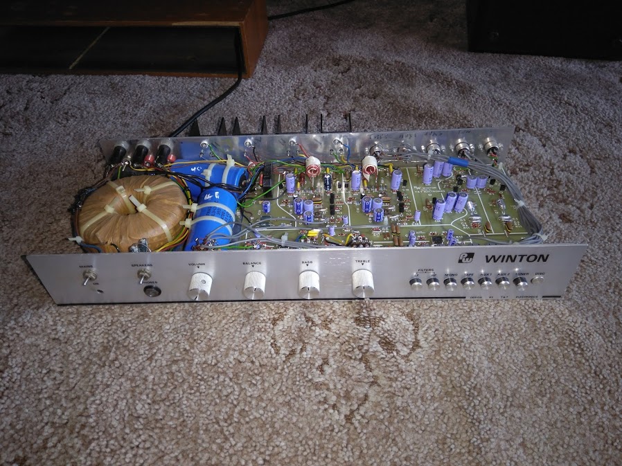

Got to have a look at the PW 'Winton' late this afternoon...
It's good :) It works although the volume pot is worn out... The build quality is not bad for a home-constructed job...
Own Work
Own Work
Own Work
Own Work
It's bloody loud and sounds good on decent speakers...
Worth searching out a new volume pot for it...
The wooden sleeve case is a bit scruffy but this amp is a keeper as it's so unusual and doubtless very rare now...
Definitely worth restoring :)
The kit of parts to build it was £120 or so in 1979 so it was expensive even as a kit...
