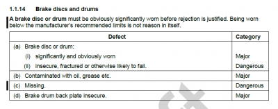

Mandrake wrote: 29 Jan 2018, 12:03 Smacks of someone in an office somewhere with a little but not enough knowledge writing these tests....
I think to be fair that the apparent errors and absurdities probably come from someone in the Autoexpress office badly paraphrasing parts of the new manual. As far as I can make out, the relevant section of the manual is 1.1.14:
MOT manual
MOT manual
1.1.14(a)(i)- "A brake disc or drum significantly and (not "or") obviously worn.
I'm not sure what purpose the 'obviousness' requirement serves here, surely the thing to be tested is simply whether or not the disc is worn, whether or not the wear is obvious (presumably meaning immediately apparent) is irrelevant, although as a matter of practical reality the wear would by necessity need to be 'obvious' to be detected in the wheels-on MOT.
Moreover, the use of the word 'significant' seems a little ambiguous and sloppy. As you note Mandrake, all discs have a stated minimum thickness. It seems arguable that even 1mm of wear to a disc is significant, yet would not be great enough to render the disc unsafe. Surely the more correct word would have been 'excessively'?
I wonder if the final version of the manual will be better worded.
1.1.14(a)(d) - "Brake drum back plate secure".
This is presumably the reg that the Autoexpress hack is interpreting as requiring the disc to be secured to the wheel hub.

The draft manual as a whole does seem poorly worded.
Mot manual
Mot manual
Ignoring the issue that, to my knowledge, almost all suspension systems incorporate a fluid damper of one form of another, and that the "gas" and "air" words, being subsets of "fluid" are superfluous, 5.3.5(b)(i) would appear to allow a tester to fail a hydro Cit with spheres that are 1bar down on spec, for the reason that even that small pressure loss would "adversely affect the functioning". It seems again that "excessively" or similar would have been a better word.
I hope the manual will be tidied up before it is finalised.

"(c) - Missing"
I can't imagine anyone presenting a car for a test with a missing disc or drum!
