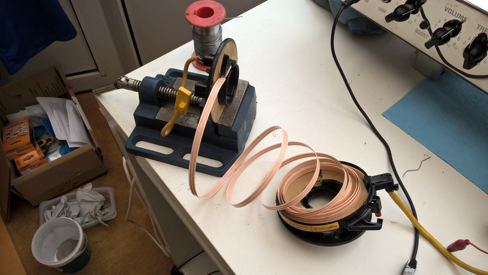

After parkrun, which I was in severe doubt about managing to get to today, I set about doing a bit to Jodie the Ka.
I've fixed her airbag clockspring so she no longer has an airbag warning light on... The repair was quite delicate and how long it will last remains to be seen but as log as it's good for the MoT...
If it does go again then I'ts not too much bother to fix it again...
Naturally, the clockspring is not supposed to be disassembled but with care it can be... I found the ribbon neatly snapped..
This was it after the initial repair...
Own Work
Own Work
One thing i was suprised about was that even after the repair i coudl not get full continuity right to the airbag connector... I then discovered a capacitor in series with the airbag... I reckon the airbag must therefore be triggered by, and tested with, an AC signal... Hence it's very unlikely am plain old resistor can be used to bodge the airbag light off as is often believed - and suggested.

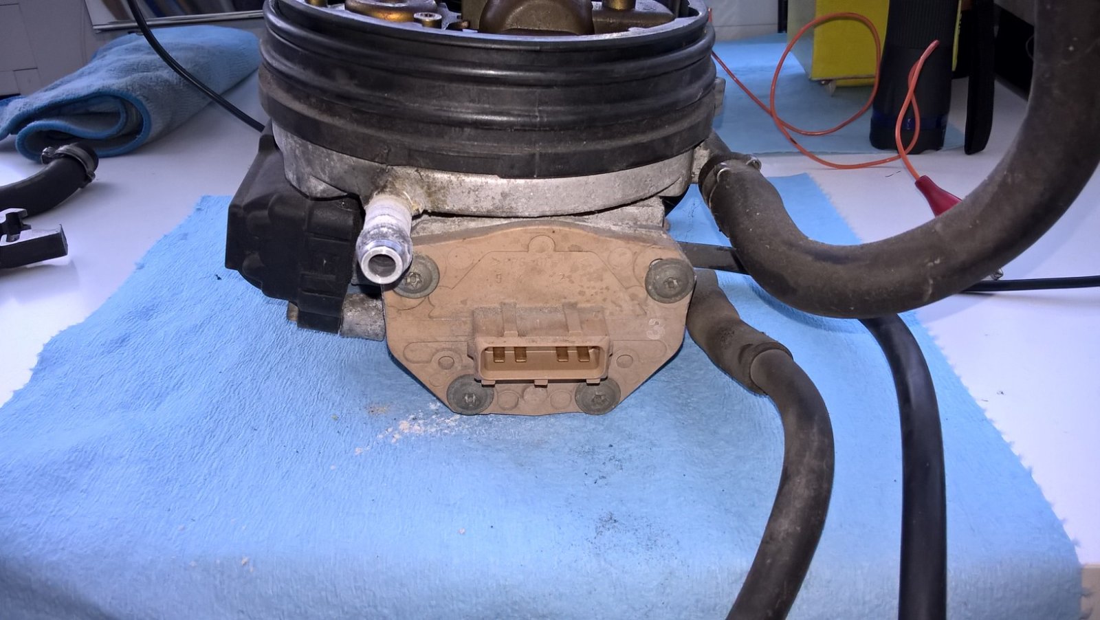

Had a look at the Saxo throttle body today, particularly with regard to the throttle pot... I plan to try swapping the pots initially as swapping the whole body is quite a task... Whereas the swap of the pot itself should be easy (ier)...
This is the device in question:
Own Work
Own Work
Sharp eyes may note it's attached to the body with Security (tamper-proof) Torx screws...
I wondered why and I also wondered why the BoL is so insistent that the pot is not touched...
Now I know! The pot is adjustable and under each securing screw are slots to allow for rotational adjustment...
Also, one screw was incredibly tight... So much so it sheared it in my carelessness :evil: I'm hoping it was corrosion rather than loctite...

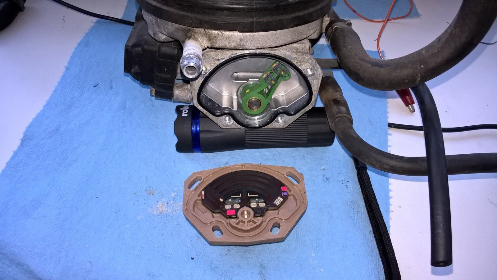

Once off, this is what the inside looks like:
Own Work
Own Work
Quite a piece of work! This one had some contamination visible so I'm hoping I can pop the one on Sally apart, clean it up, reassemble and all will be good...
Before I do so - and as I've done with the spare - is to draw a mark on the body so the pot can go back exactly where it was originally...
Also, I'll use the ELIT to make a note of the throttle butterfly angle at idle so that I can check and reset if necessary...
It's now clear why Bosch don't want you in there and why the BoL is so strident in its warning!
