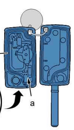

On the C4 (2006) this is the internals of the remote fob and the transponder chip is shown as the cylindrical object at 'a'
As the BSI, Engine ECU and Transponder are all based on the confidential code they need to be the same set. 'There is an encrypting function is known by the BSI and the ignition key transponder. This function permits encryption of the transponder password and decryption of the result sent by the ignition key transponder by the BSI'.

The circuit boards are for the remote locking function. It would certainly be worth fitting them with new batteries. If you look at the plain key you will see a small black object, close to and below the blade. This is the immobiliser chip. On the circuit board to the left there is something that MAY also be an immobiliser chip (although the circuit board to the right does not have this chip). The left casing has the position for that chip on the board, while the right casing has a space for a separate chip. I wonder if it is possible to buy a separate chip, and then fit it into that position. I do NOT know if the C4 chip has to be unused before it is introduced to a car, but I know that the C5 chip does (I believe that Ben82 tried to pair a used key with his C5, and was unsuccessful).
https://www.frenchcarforum.co.uk/forum/ ... =3&t=42964
x 6945
Re: C4 '06 - Programming new remotes & keys
xantia_v6 wrote: 16 Jan 2018, 19:43 Do your 'remote' keys have immobiliser chips on the other side of the PCB?
Not on the C4 (2006) fobs. They are as illustrated in the picture I posted previously of the fob.

The diagram that you posted appears to show the immobiliser chip on the same side of the PCB as the battery, which is not visible in the photo posted by teuski.

Hell Razor5543 wrote: 16 Jan 2018, 19:51On the circuit board to the left there is something that MAY also be an immobiliser chip (although the circuit board to the right does not have this chip). The left casing has the position for that chip on the board, while the right casing has a space for a separate chip.
I've looked at both the circuit boards carefully and I can't see anything in one that isn't in the other, although the black chip and tin can (resonator?)at the top right are different types.
I then prised my X7 remote fob open and AFAICS it's exactly the same as the board on the left. The item (a) on Marc's drawing isn't a chip it's a coil. Unless the immobiliser chip is inside the coil (unlikely I would think) that's not where it is.
