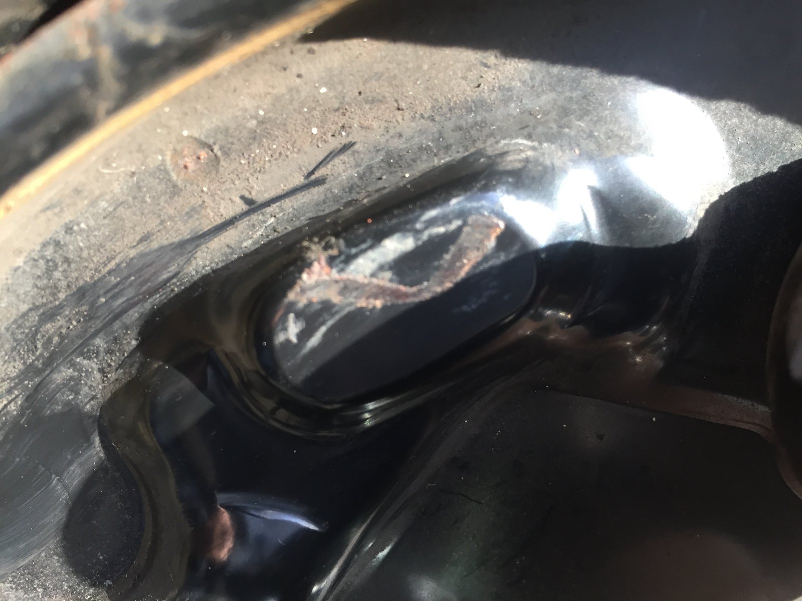

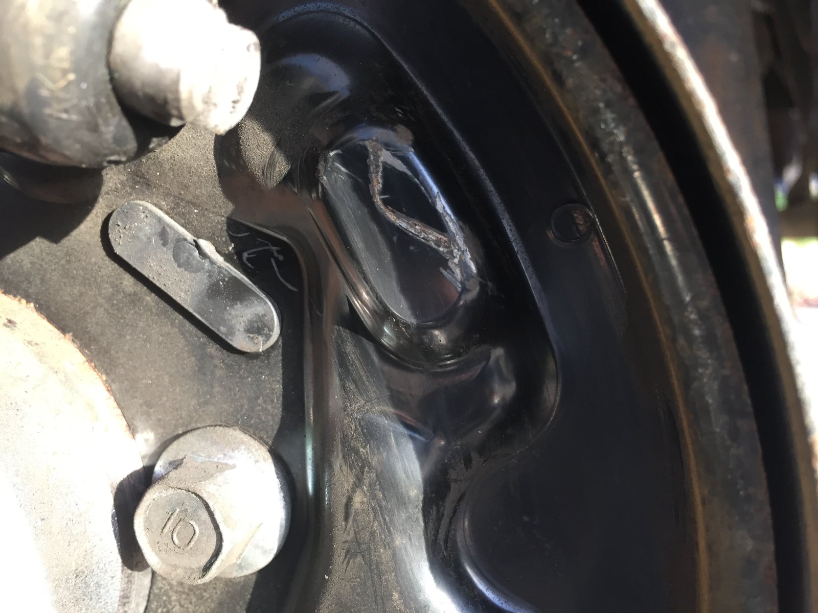

If it were me, I'd definitely be looking to rub down the three raised posts 'til smooth with a bit of wet 'n' dry or similar and see what happens with the brakes then. The fact that they did work fine after you first reassembled them but then reverted back to being grabby would point to the fact the grease you originally put on the posts did its work until enough of it was rubbed off and they went back to being grabby. You only need a small bit of grease on the raised posts once you refit it all - a quarter to half a pea's worth on each post would be fine.

I would take the paint off - you might find it's powder coated and it's harder than you think! It seems a really odd fault though - you wouldn't have thought it would suddenly lock up on constant pedal pressure if the shoes were moving - and it it did then the pedal would sink? But perhaps the whole shoe set is rotating around and pushing one piston in and the other out so there is no change on the pedal. Given that the drums are easy to get off, might be worth swapping side to side to see if the fault moves? I wonder if one of the drums is a bit oval...

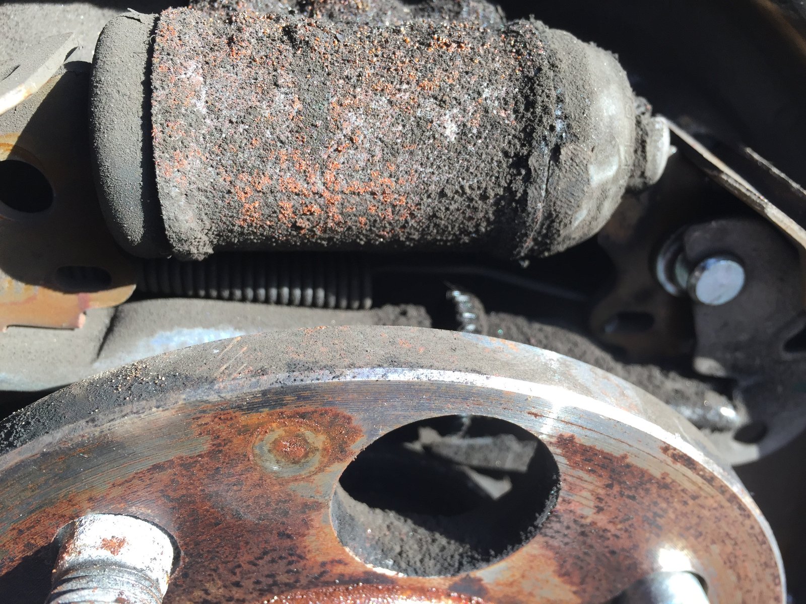

Other perusals are: Sticky wheel cylinder. Aftermarket shoes that are not spot on with size or hole spacing for springs.

lexi wrote: 17 Jan 2018, 10:31 Other perusals are: Sticky wheel cylinder. Aftermarket shoes that are not spot on with size or hole spacing for springs.
Both sides of the cylinder seem well lubricated and not sticky at all. No way to be sure they're not aftermarket shoes but I think it's highly unlikely the rear brakes have ever been touched on this car until now so I'd wager they're the original factory shoes.

This is the system used in this car. The metal edge of the shoe sides rests on raised flat pads, three for each shoe, and the top pad for each shoes is gouged right through the paint to the metal.white exec wrote: 16 Jan 2018, 17:09 The hold-back springs will pull the shoes towards the backplate, where (normally) one of two arrangements are designed:
- either one or more raised flat pads, which the shoe edges slide across (when the brakes are applied),

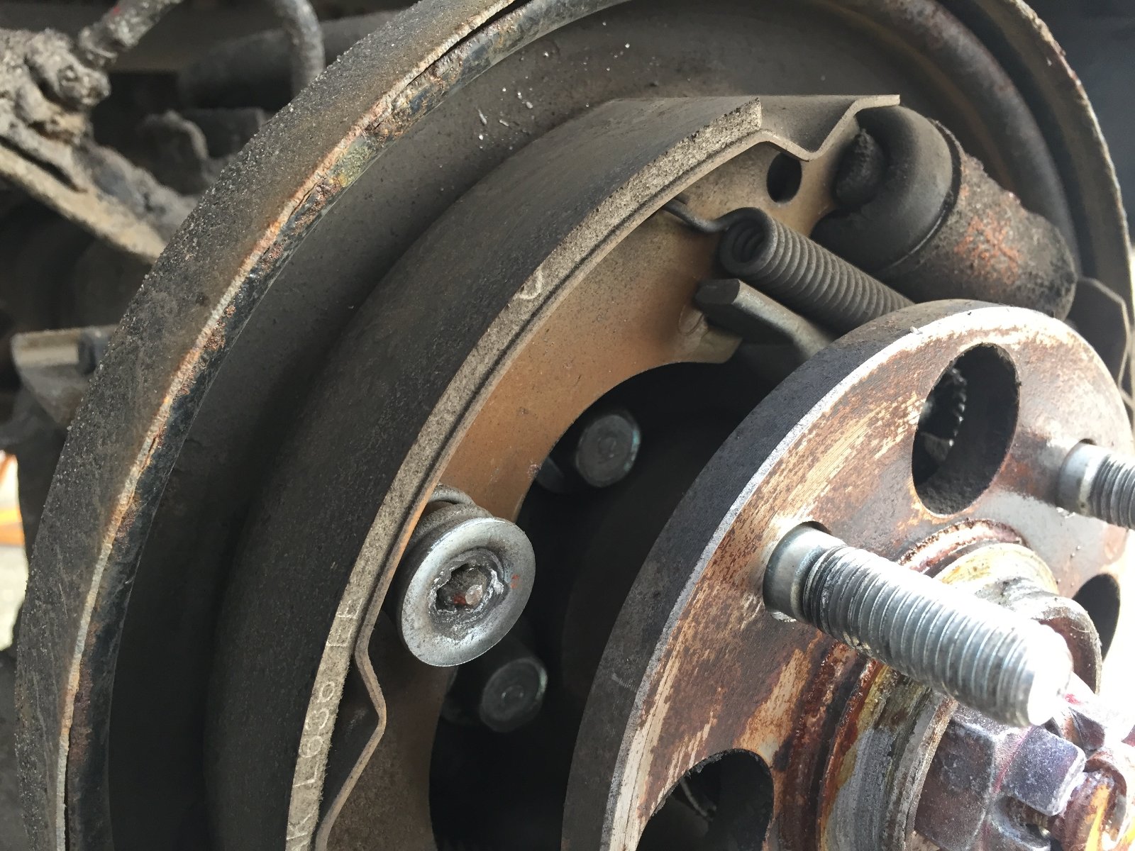

Here's a dump of all the pictures I took when I had the drums apart, some of which I posted earlier, just so everyone is clear what we're talking about. Most were taken during disassembly so are before cleaning etc:
These are the top two raised sections which are the most badly scored back rests: You can see all 6 backrests here with copper grease before reassembly: This is a picture of one of the shoes after I had chamfered the ends: That's all the pictures I have.
Before I disassembled them the shoes were not free to move sideways at the top with the drum removed - they were pretty stuck and seized. After cleaning everything, greasing the backplate support pads and putting everything back together they are able to move sideways at the top (cylinder) end relatively freely compared to before, but I can definitely still feel them "snagging" on a sharp edge as they slide across. I'm thinking (hoping) that this snagging when trying to move sideways is the underlying cause of the problem, especially when the problem comes and goes. (Maybe when you press the pedal hard it jumps onto the other side of the snag for a while)
I think sanding the pads back to a smooth flat surface is the only thing that will help but once I do that I can't undo it so I wanted to be sure I was on the right track. The only other thing I can think of is perhaps the edge of the shoe material snagging on a lump of rust on the drum edge itself - swapping the drums between sides might help prove or disprove that possibility.

Quite what kind of "cleaning" they are talking about if they are grooved I'm not sure...I reckon it will take wire brushing!Shoe Lands or Bosses
The shoe lands or “bosses” are an often overlooked item when looking for the cause of a rear wheel lockup condition. The shoe lands keep the brake shoes square with the drum and provide a friction surface for the shoes to move against. Over time the bosses can become grooved and corroded as in Figure 61.6. This grooving can allow the brake shoe to hang on either the apply or release of the brakes which can cause lockup. The shoe lands should be checked during the inspection and if rear brake service is performed they should be cleaned and lubed.
I am, quite literally, out in the field right now so have no reference material to hand, but.....
......second picture down : is that 100% guaranteed the correct routing for that spring ? It looks like it's connecting the shoe on one side to the adjuster mech on the other, is there a way it could connect shoe to shoe and miss out the adjuster mech ? As I say, I'm away from any good sources of reference material so what you've got may be the correct route.
Edit : Having got home and had a proper look at the photos on a grown-up computer, and referenced DocBackup, your spring routing is - indeed - correct. The spring on the 'outside' of the shoe goes from the shoe on one side to the mech on the other, whilst the spring 'behind' the shoe goes directly from shoe - shoe.
- x 1751
Re: Simon's new Xantia V6 and Peugeot Ion blog
Return (pull-off) springs normally link shoe-to-shoe.bobins wrote: 17 Jan 2018, 11:46 ......second picture down : is that 100% guaranteed the correct routing for that spring ? It looks like it's connecting the shoe on one side to the adjuster mech on the other, is there a way it could connect shoe to shoe and miss out the adjuster mech ? As I say, I'm away from any good sources of reference material so what you've got may be the correct route.
In that picture, the RH end of the spring does seem to be pulling on the adjuster (or is it the handbrake lever?), but where it pulls is so close to the pivot that it will be pulling on the shoe as well, I guess. Perhaps that one spring is made to do two jobs: shoe return and handbrake relax.
Simon, a latest photo above does show six (copper-greased) pads.
I'm puzzled by this photo, though. Not sure what I'm seeing there. Looks almost as if a pad had been partly ripped away, and turned upwards. Can you clarify? I'm certain those pads should all be flat.
