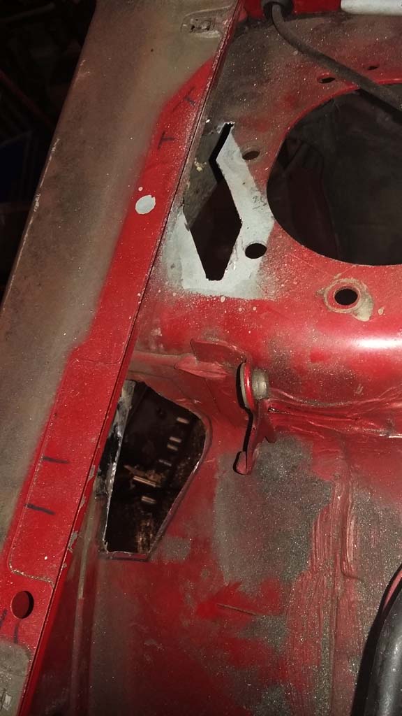

To be fair to it both areas are quite small with good metal close to the holes. There was a build up of mud under the strut top but I have not got a clue why the small part of the outrigger rotted.

They always go there... had both of ours welded in the front wings, and rot in the floor there was amongst the reasons it failed its final MOT ...

Only ittle little bitty bits at the moment.....the other side and rear is solid.

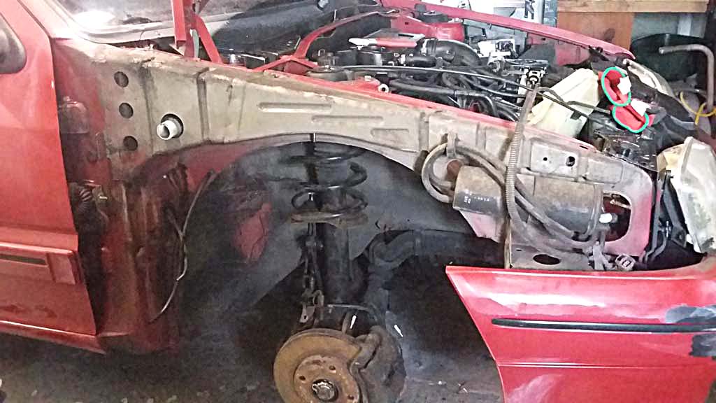

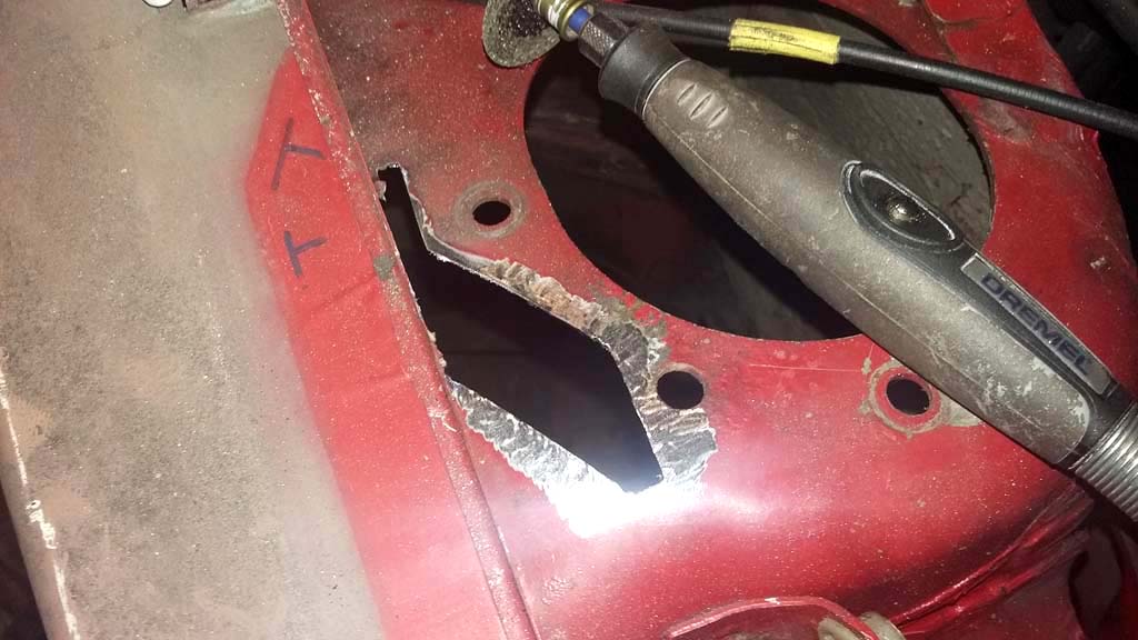

Nice and neat, not much to do really and surprisingly localised.

Ready for the repair sections to be made up.
The outer skin is all that needs to be replaced on the rail and a simple bent section to fill the larger box area.
Now I remember why I should only buy rest free cars, most of this landed on my face !
