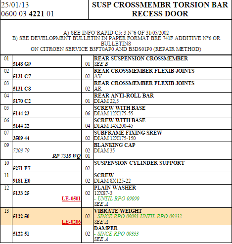

Hi Spiff - I did have a look yesterday and couldn't decide if it was these little beauties in the diagram or not - but I cannot find anything else that looks remotely like them.
Part (2) is a Rear Crossmember Flexible Joint
Part (13) is called a Vibrate Weight - from RPO 09091 (29th Sep 2001) until RPO 09332 (28th May 2002)
or a Damper since RPO 09333 (29th May 2002). So the latter in your case being a 2003. If it is a flexible damper of some sort, I wouldn't think it designed for supporting the weight of a car without some risk of deformation IMO.

Marc, I haven't used that myself (haven't needed to) and therefore haven't looked at it personally... But surely that very item (7 through-bolting 13/12/2) is the mounting point for the sub-frame to the chassis? If so that's the very point that takes (1/4) of the load of the rear of the car from the suspension to the chassis and therefore should be suitable/a very good place for jacking I would have thought (or have I mis-pictured that location in my mind).
Also FWIW (picking up on my earlier post) I seem to recall that my blocks were positioned outside the two welds that join the outer castings to the centre beam (so weight directly on the outer casting, which takes the full weight of the rear of the car anyway, albeit not in compression load from the outside of the casting at that point). Either way, I'm a qualified engineer and I had absolutely no qualms about it's ability to take the support load from underneath.

These are just what the service docs say Iain, so I'm just trying to identify the part really - as for suitability you will undoubtedly know from your own experience - Looking at Spiff's picture - it does look sort of like a flexible rubbery kind of thing - and paired with the descriptions 'flexible' / 'damper' don't convey anything solid from the description - but here's the parts list to go with it. I'll leave it to you engineers to debate... :wink:

Marc it does look to be item ( 7 ) I have pictured it from the rear of the car this time.
I have blocks under the sill at the moment, so I cannot get in there easily to picture where it mounts too.
It is metal, I reached under with a metal pole and gave it a poke : )

I've often used those round things for support.
Considering what they're called, I wonder if this is the design modification intended to reduce rattling from the rear axle in early models? I don't recall ever seeing one without them, though.
