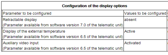

Bandit - can you advise what version of system software is installed on your RT4? The reason I ask is that only certain configuration options are available within Diagbox from a certain firmware revision.
ONe thing to be careful with here as I've said before there are a lot of options that must be set to default values - even though you may think they are wrong - as this unit is used in other models and the options are applicable to how information is output - so the X7 is different and may display info via another means.
These are the 2 areas I would check, For the Jukebox configuration, these are the correct settings. These are the correct settings for the Display option: Very important: Under the 'Personalisation Menu' Configuration Screen, there are 15 parameter option settings starting with 'Display of the "driver’s seat clearance" option', down to 'Display of the option "audible detection of an obstacle in proximity"'. ALL the options under this section MUST be set to DEACTIVATED. The functions in this section are not handles by the RT4 - they are configured elsewhere - so don't be tempted to change anything in this section.
