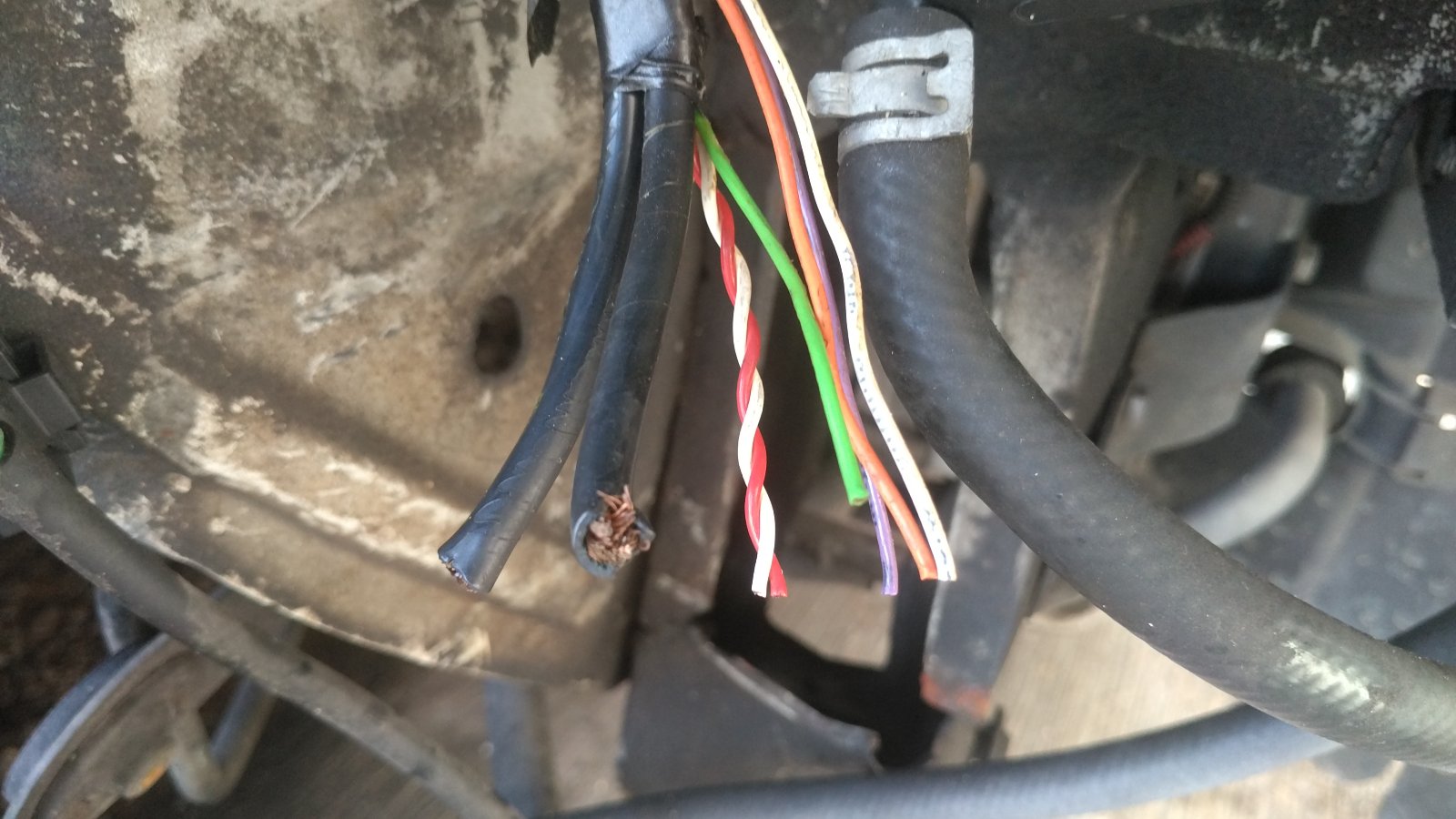

I have problem with My C5 MK2
My electric power steering pump wires have been cut off by someone.....
I need the wires confirmation before in put a new pump

Re: CITROEN C5 MK2 Power steering pump wires

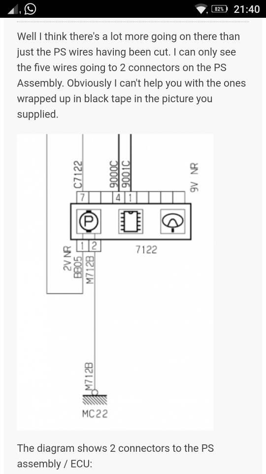

Well I think there's a lot more going on there than just the PS wires having been cut. I can only see the five wires going to 2 connectors on the PS Assembly. Obviously I can't help you with the ones wrapped up in black tape in the picture you supplied.
The diagram shows 2 connectors to the PS assembly / ECU:
7122 : power steering electric pump assembly
9 Pin Black Connector
There is a 9 Pin black connector (with only 3 pins being used): Although I have indicated the pin numbers below - be aware that they can change. Check out the wire sleeving - there should be a marking there that indicates the code below:
C7122 (Pin 7) is the variable power steering valve phase 1+ control APC+)
9000C : High Intersystem / Can bus (Pin 4) - To the BSI
9001C : Low Intersystem / Can bus (Pin 1) - To the BSI
2 Pin Black Connector:
BB05 : battery + (Pin 1)
M712B : earth 712 (Pin 2)

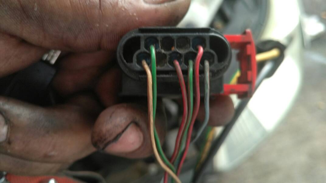

Thanks for the fast response....
I need advice on this other connect that I have is attach .....it's from other car
Please advise how do I connect it with this socket connect
Thanks in advance
Thanks in advance

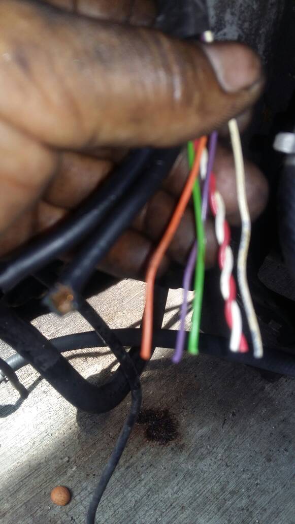

Some questions....
My C5 have 6 small wires & 2 black wires
But the digrem is for 3 wires
Please advice
Please advice
Hi
It's really going to be impossible for me to determine what is what as somebody has done a hatchet job on the wiring. It is possible that some of the 6 wires would go into the 9 pin wiring block (like in your other picture) and 2 of them go to another connector - but I cannot tell. If there is no wiring codes printed on the wires (trace the wire back up the sleeve to see) then the only way you are going to know which wire is which, is by tracing them back.
You could check another C5, but beware it may need to be a similar specification model - as there are different PS pumps and therefore the wiring may be different - also the year is important as the MK II is different to the MK I.
There's no way for me to know what the other 2 black sheathed wiring clumps are at all from a picture.

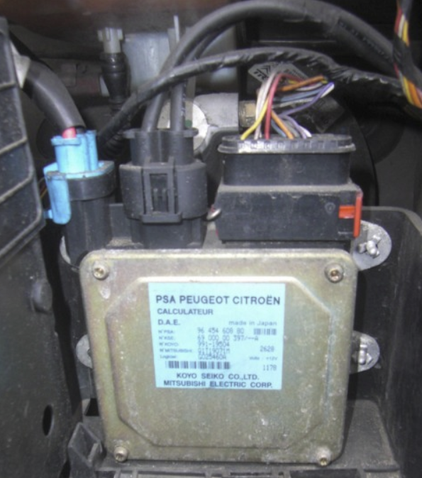

I have found this picture of a Power Steering ECU from a Citroen C3 - Now this may be different, but it may help you regarding those other wires.

I had a look on several engine types across the range Richard and even the V6 types to see if there was one with a 6 wire config - and they are all the same connection and number of wires, with a different type of ECU for the V6. This car is a 2005 C5 II 5 DOOR SALOON 2.0 i 16v 143 4-SPEED AUTOMATIC GEARBOX.
I suspect that the picture that Kumar9989 posted showing the hacked wiring cluster may well contain wires for other components that have just been routed into the sane harness TBH and that is probably adding to the confusion. So I agree that without a similar model for comparison it is going to be guesswork on this.
The CAN communication wires are for the ESP for vehicle speed to alter the assistance of the pump, so getting these right will be key and could mean all or no assistance if not connected correctly I suspect - amongst other issues no doubt!
