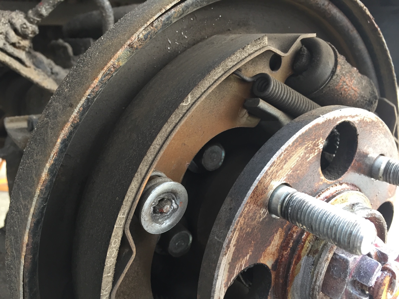

Thanks guys. I’ve started on the job and just got the drum off. There is loads of built up lining dust that you can see in the pictures below in the drum and elsewhere.
Initial impressions - inside surface of the drum looks and feels perfect. Linings both have 3.5mm material left and are not delaminated. They actually look fine.
No obvious problems yet except the build up of dust so I’m hoping a strip, clean, lube adjust and reassemble may do the trick!

Re: Simon's new Xantia V6 and Peugeot Ion blog
Just looked up the lining thicknesses in the service data I have - new linings are 4mm and the minimum allowed is 1mm, so at 3.5mm they're hardly worn!
The maximum inside diameter of the drum is specified too, I went to measure it with my digital vernier until I realised it only goes to 150mm...
So I'll just have to take it on faith that the drum diameter is OK.
I do notice a bit of a rust lip on the edge of the drum on the other side of the car which might potentially brush against the edge of the lining so I'll see if I can sand that back.
And yes I'll give the end of the linings a slight chamfer as well as they are square at the ends...
One thing I have noticed is that when I try to rock the linings they don't slide across the backplate very smoothly they seem to be grabbing quite a bit, so I wonder if them not moving freely on the backplate due to lack of lubrication and build up of dust is the main issue. Still undecided whether to use copper grease or normal lithium grease on the backing plate slides.
With the linings held away by the hand brake, both pistons seem to slide in and out freely and smoothly on both sides of the piston so I'm not going to touch the cylinders - I forgot to buy any dot4 fluid anyway.
Right, tea cup down and back to work.
