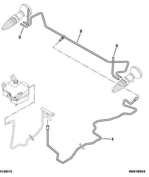

You may just have a leaky boot, so to speak! Have a look at these diagrams from a 2001 C5:
Below is the return piping only (not the supply pipes), so you can see numbers (3) are the tank venting pipes: On the following is the assembly of the rear sphere parts - so you can see the boot (3): If you require part numbers, PM or post your VIN

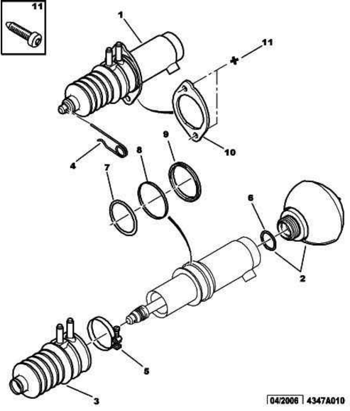

The pin mentioned is this part of the clip that holds the boot on, or something that has to be removed to get the boot on ?

The pin in question is shaped very much like a big capital letter R. The long straight edge goes through a hole drilled through the ram. The top semi-circular section holds the pin so it doesn't fall out - not a problem when it's seized in though.
- x 6956
Re: Citroen C5 2003 dripping fluid from passenger rear suspension ram boot
It's Part 4 on the diagram!

So you get the clamp off at the wheel end.
Then the pin out at the end furthest from the wheel, I see from another posting it can be rusted in ?
Once it is removed will the assembly just drop to allow the boot to be removed ?
When pulling that pin out is anything going to move a lot, such as the wheel ?
I only wish I had a lift as you do I have to rely on ramps.
Should the car be off its wheels and jacked for this job rather than on ramps ?
