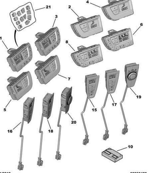

Re: C4P 2007 Climate Control
Joe
As you can see, there are a few different types - yours are numbered 7, 8 & 20 in the diagram. Ignore the rest.
Just for reference, number 20 on the diagram is the Heater / Ventilation control.
- Number 7 is the Left control and is part number 6451 WY
- Number 8 is the Right control and is part number 6451 WZ
- The heater / Ventilation Control is Part Number 6451 XH
Part 8 will be the bit he's interested in, Marc - C4P has two separate heater controls in the front, one at each end of the dash. The bottom row of parts are for controlling the rear fans / heat on some models.
Deetails of how to remove the panels: https://www.frenchcarforum.co.uk/forum/ ... 0&start=39
This part new is a highly amusing £370.10

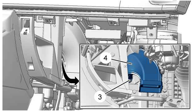

I now find vented Hot air on passenger side and Cold vented air on drivers side, so am I right in saying there's a problem with the top servo/flapper valve (Dual Zone Air Con) if so - how the hell do I get at it cos there's a clear plastic duct in the way and to get at this I will have to remove the Knee AirBag ( can this be removed Safety )
Is there an explanation/exploded view of Dashboard removal - this is turning out to be a bit of a long winded job, lets hope for a mild winter not sure if Father Christmas wants this cos he may have to put wheels on his slay and go all electric...joe

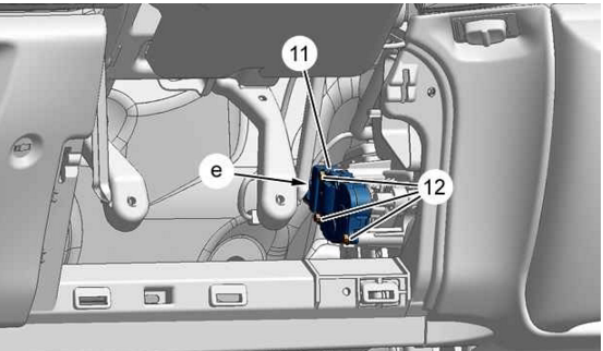

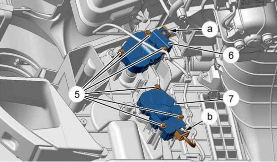

Unfortunately the guidance (like most of them) is for Left Hand Drive - so it's all back to front. I've just included the diagrams to show which ones are which, so id doesn't confuse you. So assume 6 & 7 are on the right hand side and 11 is on the passenger side
The distribution micromotor is (6)
The mixing micromotor is (7) The mixing micromotor is (11) So on the passenger side, it's a matter of removing the glovebox to get access - or on the driver's side one they say to remove the steering column air bag (caution there - battery disconnected and wait 10 mins).
