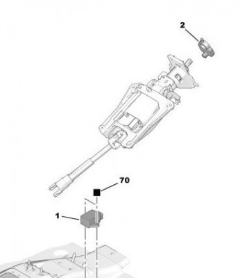

Re: Steering Rack Leak(?) + Outer Driveshaft Boot
Better get near a couch Stu....
Part number 2, (4545 H8)
ahhemm
£477.67
PS including VAT 8-[
