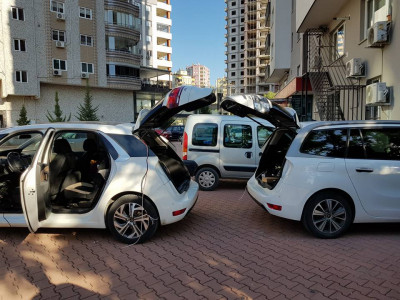

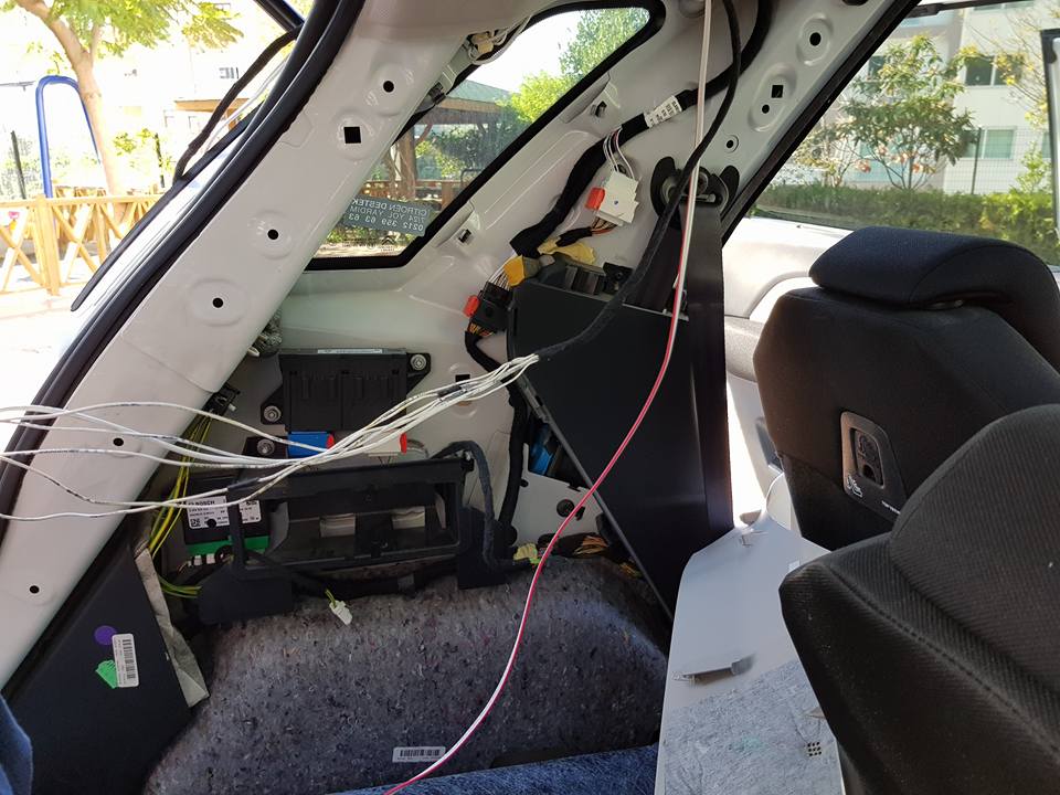

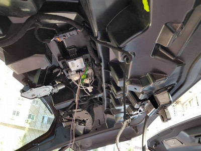

Hi Everyone,
I used old ETG6 gearbox grand picasso and new EAT6 gearbox Citroen C4 Grand Picasso. My first picasso has electric tailgate and when I bought newer picasso it does not have electric tailgate. I bought used parts (struts, tailgate computer, lock mechanism) to my new picasso. I installed successfuly also I installed two cars after my first installation. I added foot trigger opsion to open tailgate without touching open button. Just put your foot to under bumber like new MK2 model!
If you have any question I can help to you or If your car has electric tailgate I can convert tailgate open operation from manual to foot trigger

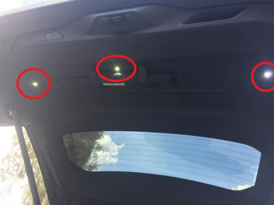

If your car has a foot trigger you have MK2 Picasso. You can add additional lights on boot lid and you can add open / close button on dash board. There is no option open / close inside of cabin.
momag46
- Posts: 238
- Joined: 20 Feb 2013, 20:49
- x 78
Re: Citroen C4 Grand Picasso aftermarket electric tailgate with foot trigger operation
Yes estebanfree, it’s a mk2 (2017) and you are right, no internal control for the tailgate.
What ‘additional’ lights do you mean?
Maurice
Maurice
1999 V6 Xantia
estebanfree
- Posts: 8
- Joined: 11 Dec 2017, 07:42
momag46 wrote: 12 Dec 2017, 17:17 Yes estebanfree, it’s a mk2 (2017) and you are right, no internal control for the tailgate.
Maurice
you see there were 3 LED (Eagle eye 3W) I added them..
momag46
- Posts: 238
- x 78
Missed them on your original post
they look good.
Maurice
Maurice
