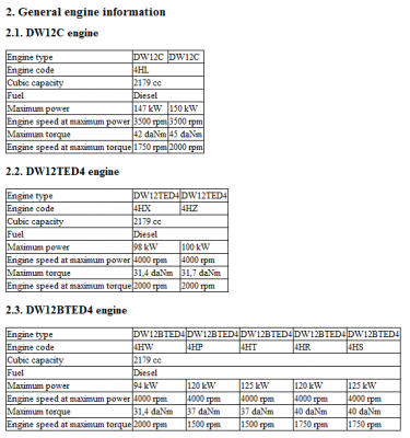

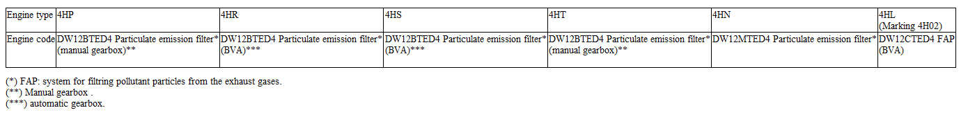

For a start what year are we talking about for the C5? MK I or MK II? And with or without particle filter?
Here is some basic info for the 2.2 Engines from the C5 MK II:
Click to Zoom these

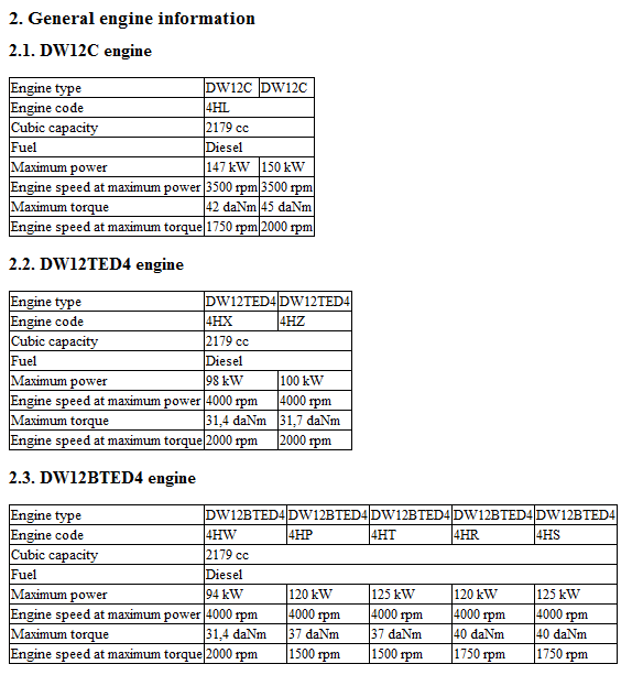

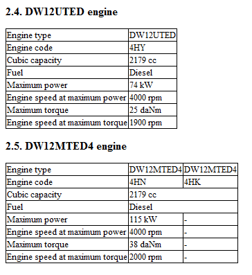

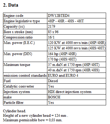

Click to Zoom these

Hi
Thank you for infos very useful
My c8 is 2004
Engine out of mk1 c5 year 2002
Dpf is deleted and egr too on my car so that want play a part .
Looking as some photos i have it looks like exhaust manifold is different but that can be swaped.
