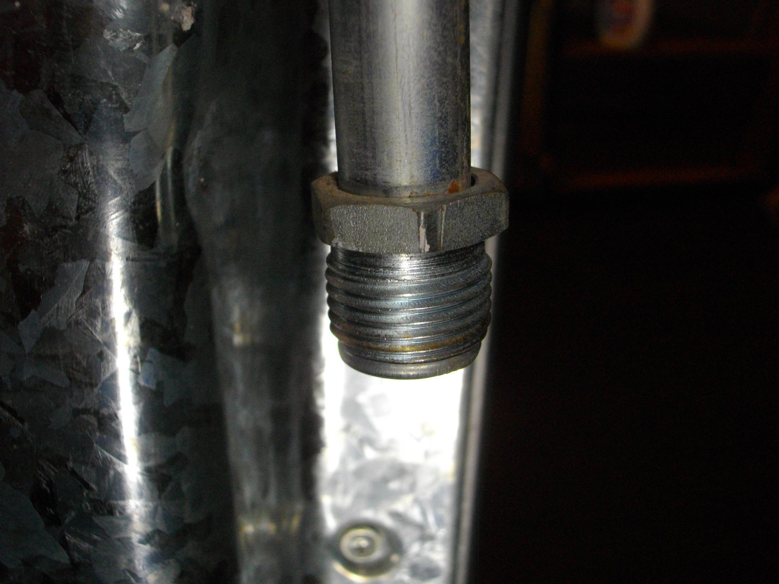

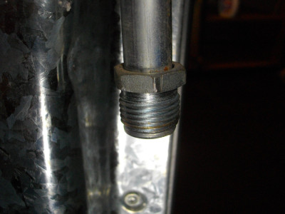

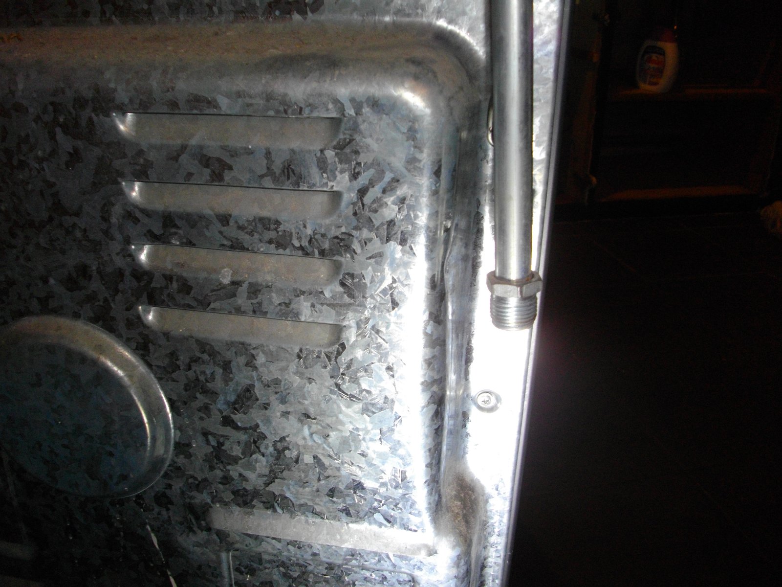

RichardW wrote: 29 Nov 2017, 08:08 Is that threaded, Steve? You might just need to screw an adapter on to it.
Yes, it is threaded. I wondered if anyone else here had encountered the same - could it be LPG? I rather doubt it but haven't ever worked with an LPG system.

myglaren wrote: 29 Nov 2017, 21:44
It could be - worth a check of the rating plate to make sure it's 20mbar nat gas!
It's probably 1/8th or 1/4 BSP - you should be able to get a sleeve adaptor threaded both ends that will allow you you screw in the hose; although you may need a second adaptor if the thread in the hose is not the same. If it's BSP then it should seal on a washer, but not sure there will be anywhere to put on - a good few turns of PTFE tape around the end should make it seal against the back nut, just check with soapy water it's gas tight!

Incidentally, I managed a better photo of the curious coupling.
Own mess.
Own mess.
Own mess.
Own mess.
The only adapter I have found is from B.E.S. and is a line coupling, not confident that this is what is needed.

Is that nut loose on the pipe, Steve? In which case it needs the correct fitting to seal against the flare on the pipe - can't think what it would be called.... maybe ask the maker of the cooker, but then they'll probably just reply that they can't tell you anything if you are not Gas Safe.
Zelandeth
Posts: 5303
Joined: 16 Nov 2014, 23:36
x 1593
Re: Confessions of a Citroholic
Unread post by Zelandeth »
Can't say I've ever come across that fitting before either - though it's unusual for me to be touching anything less than 30 or 40 years old!
