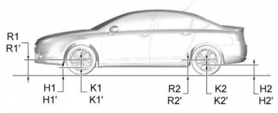

Identification: Measuring zones - Vehicle heights at setting height
Wheel radiuses R:
  • R1: Front wheel radius (L.H. side)
  • R1': Front wheel radius (right)
  • R2: Rear wheel radius (L.H. side)
  • R2: Rear wheel radius (right)
Heights H:
  • H1: Height between the measuring zone under the front LH subframe and the ground
  • H1': Height between the measuring zone under the front RH subframe and the ground
  • H2: Height between the measuring zone under the rear LH axle crossmember and the ground
  • H2: Height between the measuring zone under the rear RH axle crossmember and the ground
Heights K:
  • K1: Height between the wheel centre line and the measuring zone under the subframe (left hand front)
  • K1': Height between the wheel centre line and the measuring zone under the subframe (Front RH)
  • K2: Height between the wheel centre line and the measuring zone under the axle crossmember (rear left hand side)
  • K2': Height between the wheel centre line and the measuring zone under the axle crossmember (Rear right hand side)

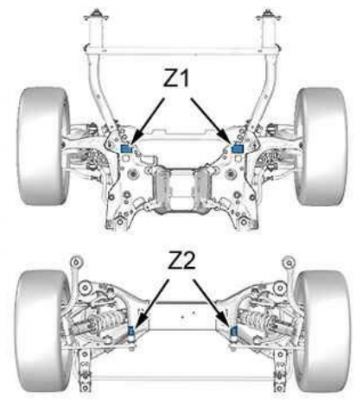

"Z1" : Measuring zone under the front subframe.
"Z2" : Measuring zone under the rear axle crossmember.
