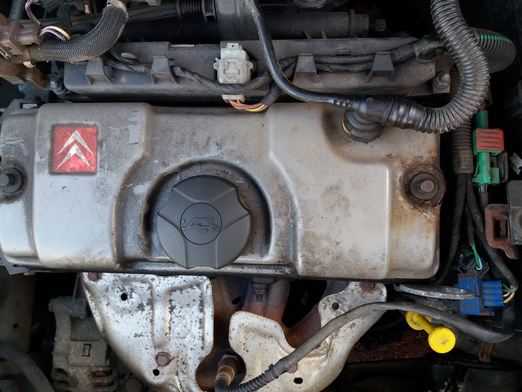

Daughter's water temp sender on the C3 is playing silly wotsits.
New one just ordered, but tentative attempts to separate the two parts (small screwdriver levering inwards ie towards the sender itself) came to nothing....
...and you know how it is with these things when you're unfamiliar with how they come apart, don't know whether to press it, lever it, ease it, or just give it a pull.
Could someone advise please.
Thanks :-D
NB: I'm guessing no need to bleed upon fitting new 'un?
Its the 1.1 Petrol on an '05' plate.

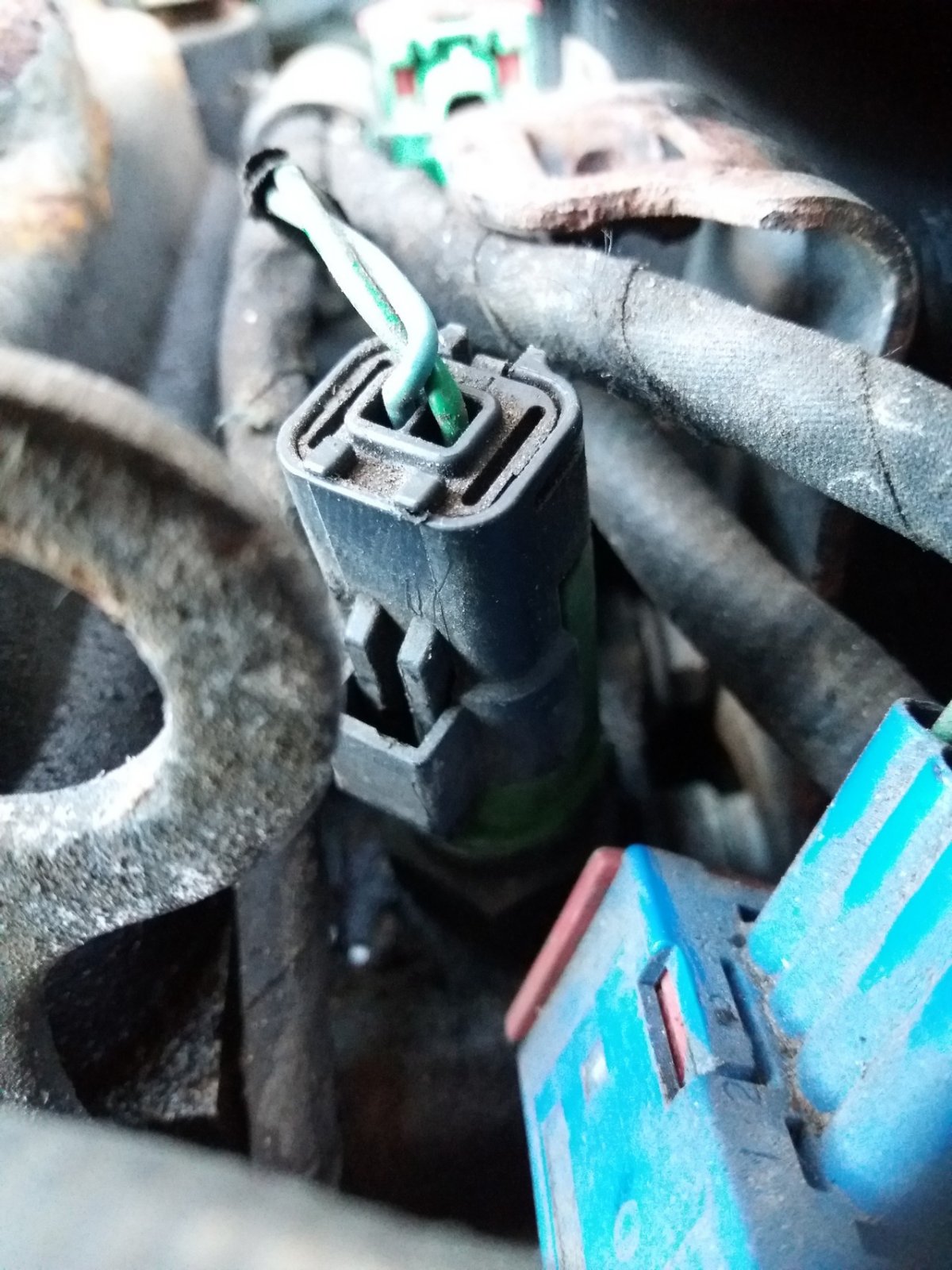

I THINK with that plug, a small flat blade in between the casing side, just behind the 2 downward prong looking clip and ease the screwdriver outwards, moving the 2 pronged clip away from the plug whilst gently pulling.

That plug looks like a typical Citroen latch design. IF you can get to the end away from the wires there should be a latch you lift to allow the plug to pull away from the socket. I am looking along the body of the plug, where there are two (actually it is one) latch going under a 'cover'.

thanks Guys, that'll sort it; simple thing, but awkward at the same time.
