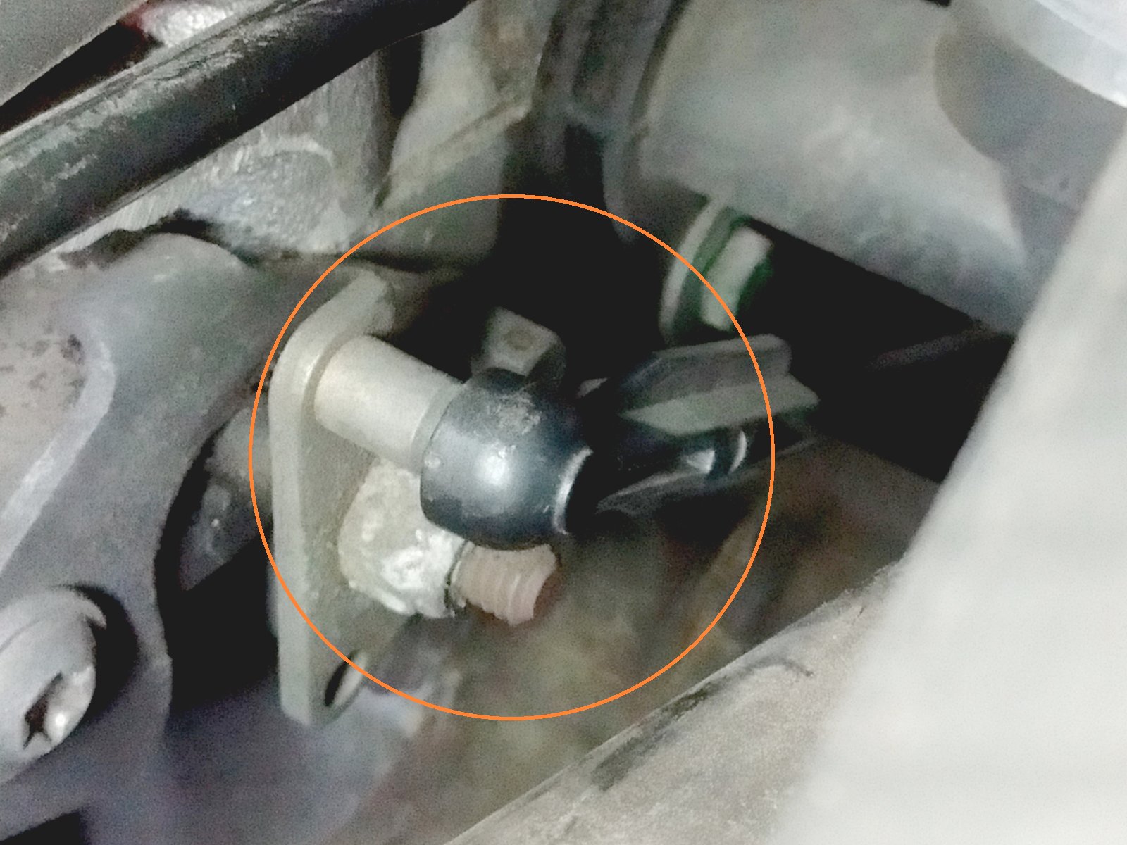

Q: Whilst we had the bonnet up we noticed a ball end had become uncoupled and needs replaced as too loose a fit (see pic, whilst attached). What is this and could it be the cause of the temp issue.

The little plastic linkage is for the swirl flaps in the inlet manifold, nearly every 2.2 you lift the bonnet on this has come off or broken. It wont be causing your problem & has probably been like that for months if not years.

Ah yes its for the swirl flaps now I remember!
