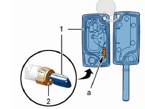

Hmmm... Not so sure Paul - this extract (for the X7 at least) would indicate that the Ignition Key Transponder also has some ability to perform a calculation. Probably another reason why the X7 only has the electrical remote fob if this is the case.
First - clarification of the terminology using this diagram: (1) Ignition key with integral transponder.
(2) Transponder coil .
"a" Ignition key transponder.
Ignition key transponder authentication request
When the ignition key transponder has been identified, the BSI1 sends an ignition key transponder authentication request.
The ignition key authentication request sent by the BSI1 contains :
