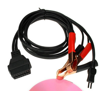

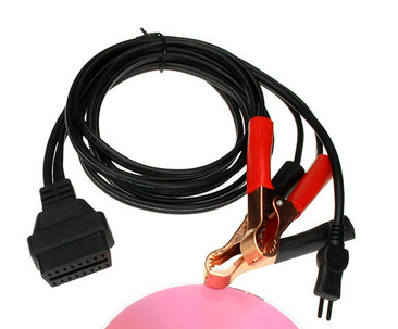

Re: Merged Lexia & Diagbox threads
What is this for?
Is it to test the battery?
How do i?
Cheers
Stu
How do i?
Cheers
Stu
- Attachments
Stu
Onlinefurriegurrie
- Posts: 191
- Joined: 07 Dec 2012, 15:21
- x 36
That a connector for older Citroëns like serie 1 XM. They do not have a central odb socket bit a connector per ecu. The clamps are for power, connected to the battery
- x 6956
viewtopic.php?f=3&t=46686&hilit=it%27s+ ... 35#p555617Sloppysod wrote: 13 Nov 2017, 20:49 What is this for?
