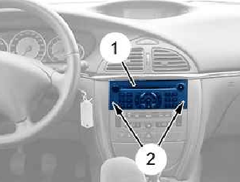

I've seen a video on youtube showing how to dismantle the radio. looks quite simple. it shows that a torx screwdriver is needed. since the presenter speaks Spanish, I wasn't able to understand what size of torx is needed. any idea?
- x 6950
Re: Radio mute on C5
They are 2 x Torx 10 Screws
