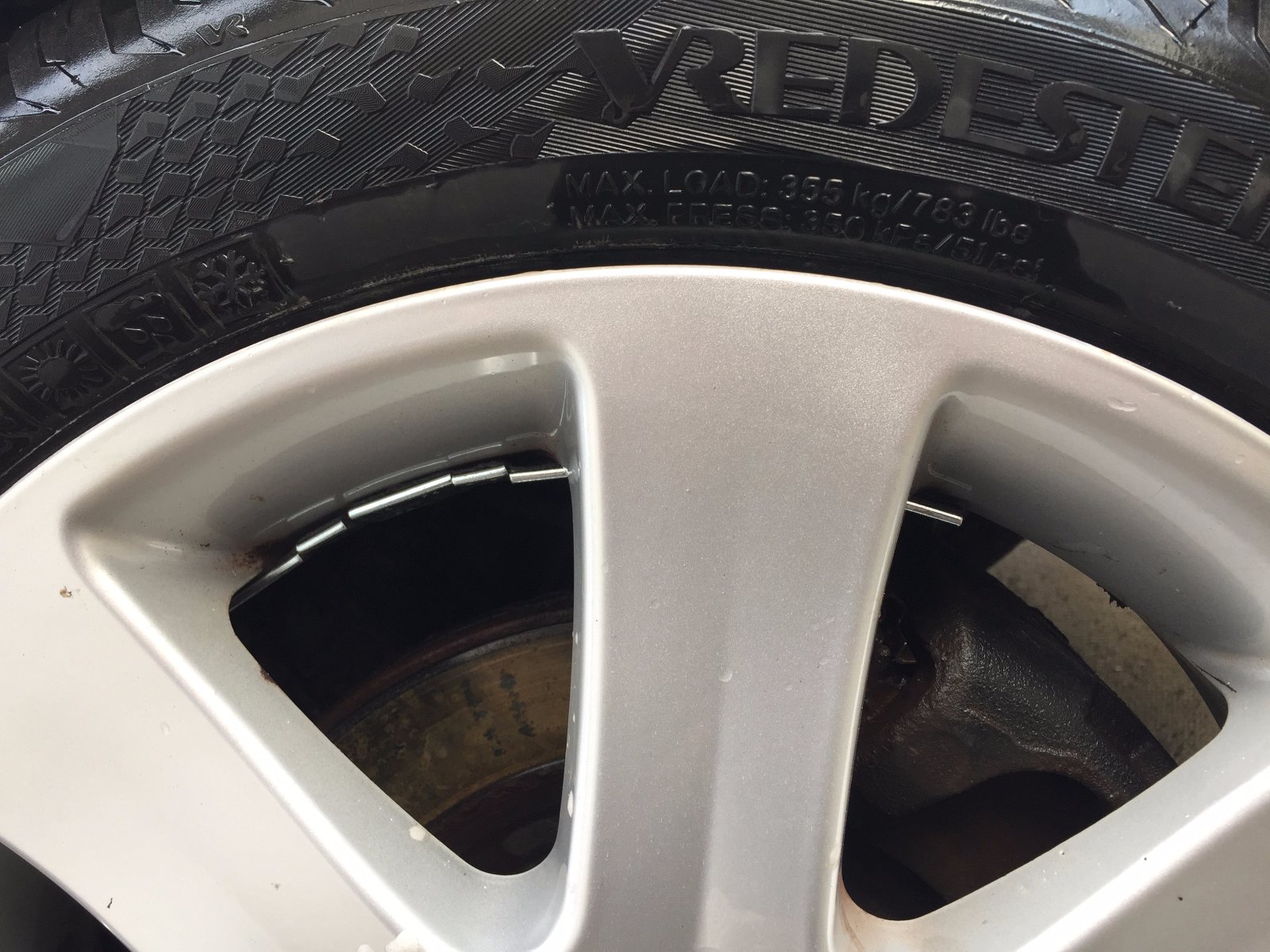

One thing I did notice in last nights inspection is that both front wheels especially the left one have a lot of balance weights on them. More than I have ever seen on a wheel before.
On the left wheel it literally has a continuous line of adhesive balance weights around about a 30 degree rotation of the wheel. :shock: Then on the opposite side of the wheel about 20 degrees worth of continuous weights... That can't be right surely... The right wheel doesn't have as many but still has a lot, and has two opposing rows of weights as well. (Why ?)
The worst vibration is around 70-80mph which would be typical of an imbalance, but if it was a wheel imbalance would braking hard cause the vibration to get much worse ? Perhaps due to throwing more weight onto the front tyres, which are normally lightly loaded as the car is rear heavy ?
I think the next step is to take it back to Cooper brothers and see if they will re-check the front wheel balance for free because I really don't think it can be right. I should not be noticing a vibration on the steering wheel and the excessive number of balance weights reminds me of the times that the Xantia wheels were incorrectly balanced - they (another company not coopers) were adding a lot more weights than they should have due to a wrong reading from the machine.

This sounds like a balance problem or a faulty tyre. A faulty tyre sounds likely. I've had this on a Xantia where it would vibrate badly. Took it back 3 times to be rebalanced and they gave me 2 new tyres in the end. The amount of weights on yours sounds like that tyre could be faulty and they've tried to balance it up. Are your tyres the same size front and rear, if so, swap that wheel to the rear and see if the front now behaves..
In any case, take it back. It's their problem if it wasn't doing it before.

I'm in agreement with you here Mike and the fact that a lot of balance weights were needed smells a bit of suspicion... I believe it's possible to put some weights on initially wrongly and keep on adding weights to try and compensate whereas what they should have done was to have ripped them all off and started again...
I've known one case of duff wheel bearings causing bad vibrations but that was at all speeds, not just at high ones... So it's very unlikely to be that..

I'm also a bit unhappy about how they have positioned the weights on the right wheel - they've put them too far towards the outside of the wheel so that some of them are resting on a curve and I can easily wobble them with my finger, and I suspect a couple will fall off as they don't feel very well stuck on:
That seems pretty sloppy to me ? :evil:
