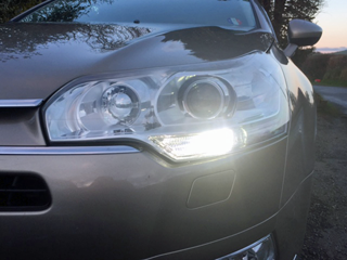

Do the C5 come with Xenons?
No, they are an optional extra. Models with the Directional, Bi-Xenons look like this on a 2008-2011:
