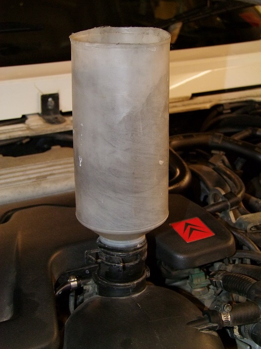

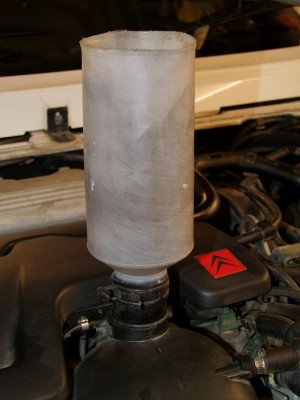

For a thorough bleed, on XM - where header tank is above engine, but not as high - mandatory procedure is thus:
- Fit bottle (piece of old radiator hose is firm fit into the expansion tank neck, and blocks drain hole) and half fill with coolant.
- Bring engine up to normal working temperature (may take a while when idling!), and maintain bottle half full.
- Open bleed screws in turn [on XM, there is also one on the heater matrix supply pipes next to bulkhead].
- Squeeze one of the large hoses vigorously to encourage air out.
- Continue until cooling fans have cut in, preferably twice.
- Keep header bottle at least half full throughout.
- Leave engine to cool, with header bottle in place.
A 1-litre bottle is sufficient. If it vibrates unacceptably (because expansion tank is engine-mounted), hang a heavy weight from the bottle top rim.
Could be a bit OTT for yours, but it is thorough.

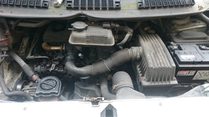

By the way, for a 23 year old car, that's a clean looking engine bay.
