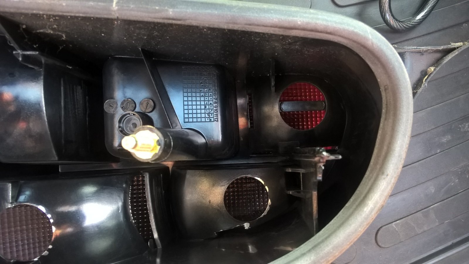

I noticed Sally had one rear fog out and one front fog out... The front was easy - just a bulb. And despite it looing quite a task, swapping front foglight bulbs is noit difficult
The rear was a bit of a surprise... I pulled the light cluster out and found there was no bulb in the holder! I popped one in and before replacing the bulb carrier in the cluster I checked it worked and it did
However, when I came to pop the carrier back in the cluster it wouldn't go in
Reason was a 'bar' across the bulb hole in the cluster as shown in the picture below! There was never a bulb fitted
I popped out the 'bar' and reassembled and Sally now has two rear foglights for the first time in her life!

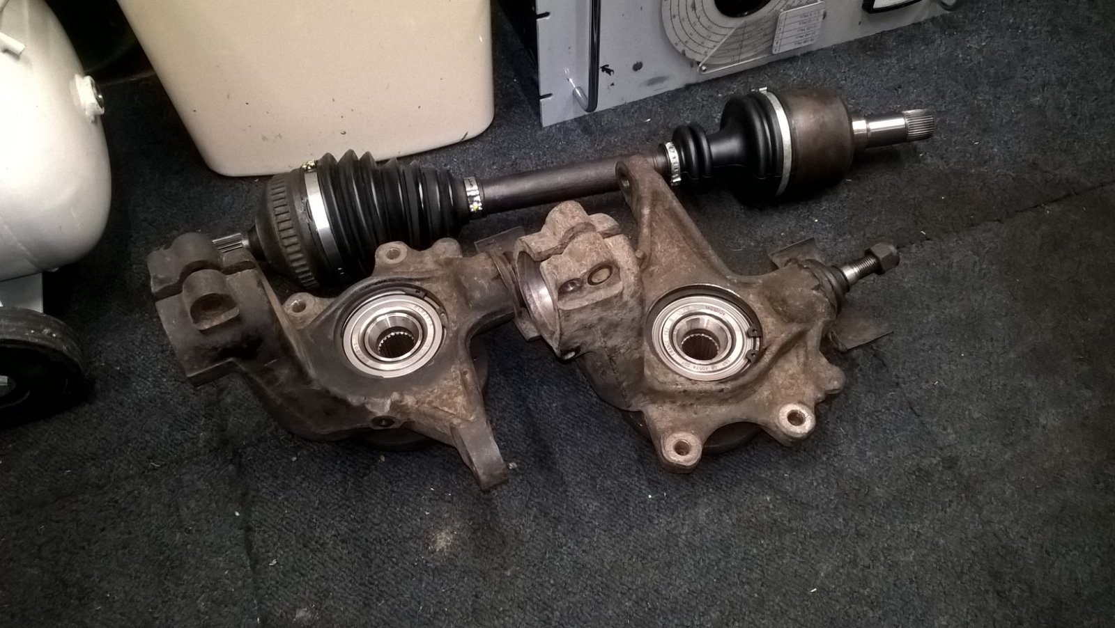

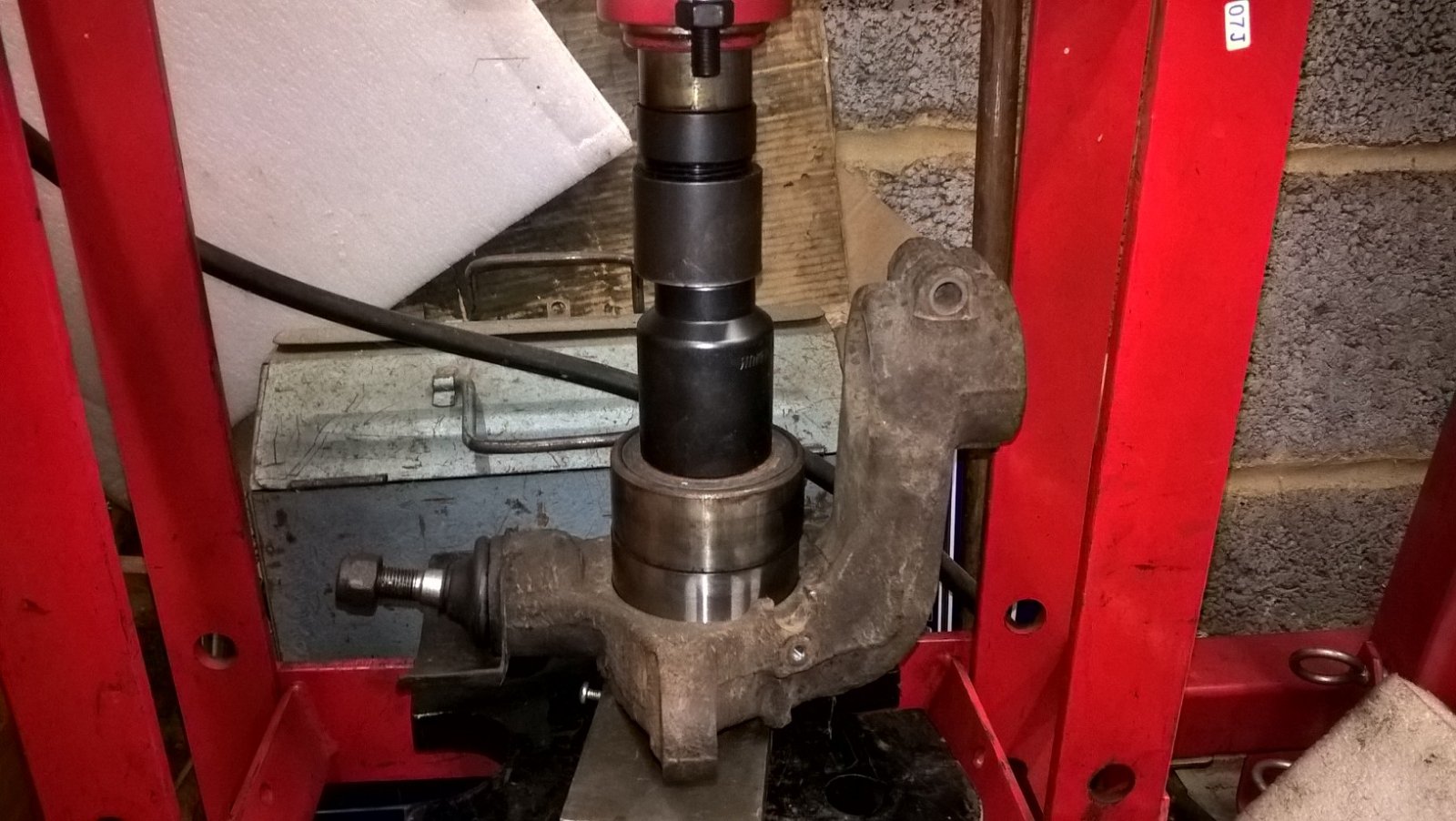

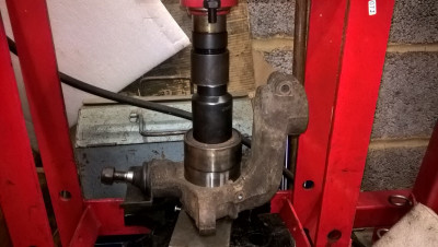

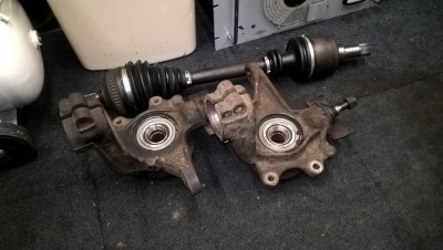

Next up, I pressed the new wheel bearings into the Activa hubs...
Now the hubs and driveshaft is ready to be refitted
