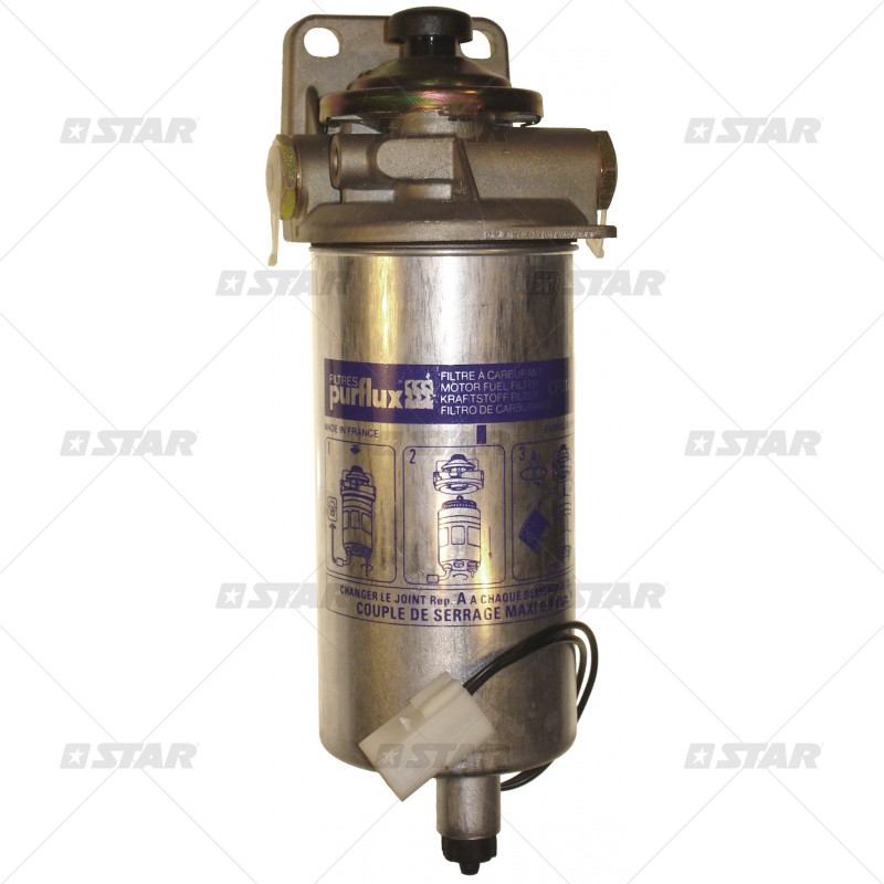

If a Purflux filter like this one, there is a micro-fine gauze filter under the output banjo bolt.
Remove the whole filter, remove bowl and element, and relevant parts are in the head.
If dissembling, essential that you make a sketch of the bits you take out - must go back in exactly the same order/orientation, especially the tiny one-way/non-return valves.

superloopy
Posts: 3344
Joined: 30 Mar 2005, 03:25
x 19
Re: Xantia 1.9td air ingress question ...
Unread post by superloopy »
This has confused me ... where exactly on the filter housing would the gauze filter be? This is a mk1 1.9TD and i cant see where this would be. Changed filter a good few times and never seen a gauze microfilter. I'm going to check a few part numbers on service.citroen tonite, see if i can get pukka swapin parts.

x 1751
Sorry if I confused. Likely your filter head isn't like this (photo added above). Ignore if not relevant.
