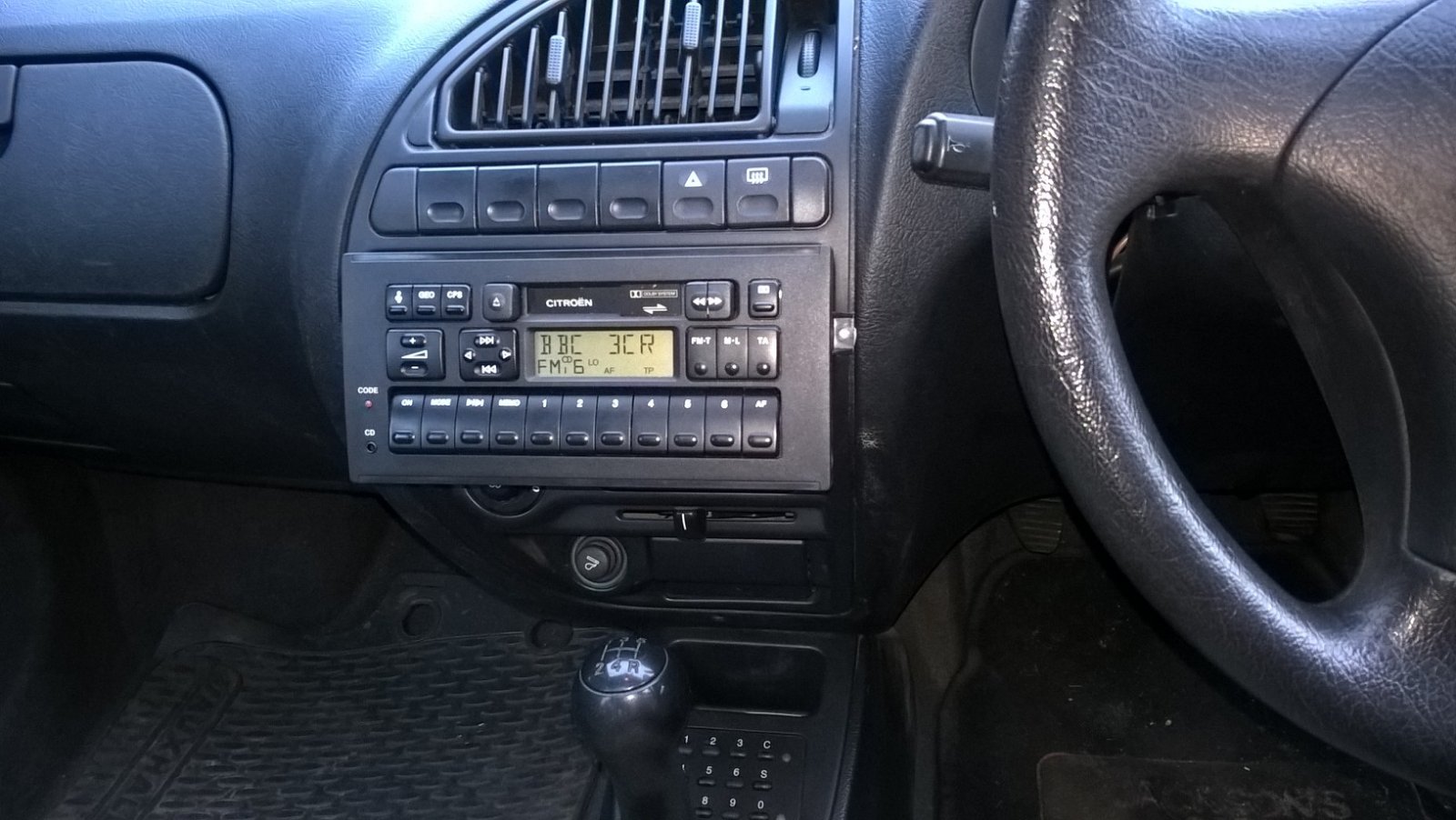

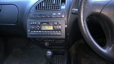

I've not yet received the spares to fix sally's proper wireless and keen to have at least some sort of wireless in the car I dug out an old Xantia wireless today and it does sort of fit...
I know it's a proper bodge and not good but it is only temporary :)
At least I now have a wireless to listen to...

Looks ok to me Jim. I once put a Xantia stereo in a ZX
... using copious amounts of no more nails.. Now, that was a bodge!
