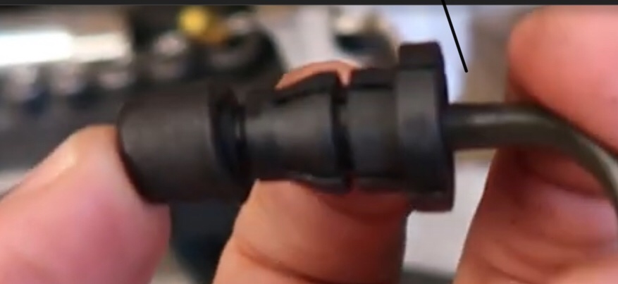

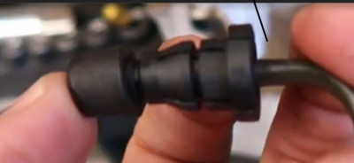

matej
- Posts: 4
- Joined: 19 Nov 2020, 21:33
Re: Xantia HDI 110 Clutch slave kaputt..
Just changed the clutch bearing on my xantia and everything fine except the leak on the connection of pipe on slave cylinder. I found the problem is the missing rubber and I ordered it, I will get it tomorrow but as I’ve seen on some youtube video, the rubber is slightly bigger then I expected and I just realised that it is what I’ve seen inside the cylinder. So it got stuck in the cylinder hole and slipped off the groove from the black plastic connector and when reconnected, it doesn’t slip back into the groove as it used to be. good but I will get the new one anyway as it will seal definitely better than 20y old.
Btw., haynes book is saying that clutch bearing cannot be replaced without replacing pressure plate, but it’s easy to push the bearing in direction to the engine and probably free it from there by removing the clip if you remove the pressure plate. I bought the bearing only, in advance so I pushed the old bearing through the pressure plate, but cut off the bigger part of it with angle grinder first. Haha. What was left of the bearing was just a pipe with constant diameter which went easily through doing no harm to the pressure plate. I couldn’t just remove the bigger parts as the inner ring is getting bigger on the end and wouldn’t go through. Pressure plate and friction plate were in good condition and it only takes time, patience and some skills to remove everything, so I saved some money. Wiggling the gearbox to get it from engine bay was the hardest part. But at least I was happy there is an eye for hanging on top of it (if it was ment for hanging) so I hung it and that helped a lot, it’s almost above the centre of gravity so pulling the rope with one hand and rotating the gearbox as needed with the other hand was good enough. Have to say I had the hoist made of three pulleys, so the weight I was pulling was third of the real weight. Loosening of wheel nuts was impossible so I just took the wheel hubs off the lower arms and top struts, that gives enough place to move the driveshafts away. Also no need to use special tool to
pull the fork to connect the clutch bearing to the plate, as piece of rope loop hooked on the fork did the same job.
If it helps someone, the rubber piece nr. is 215615
