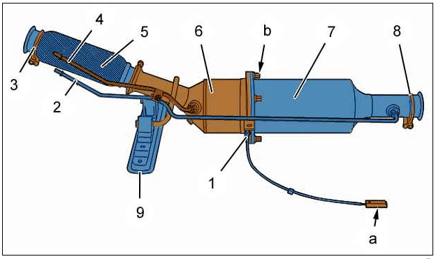

Ok, so here are the removal instructions for the DW10BRED4 (yours) and DW12TED4 engines:
Wait at least one hour before carrying out any work on the exhaust line.
  • Disconnect the battery negative terminal.
  • Raise the vehicle.
  • Remove the sound-proofing panel from under the engine.
  • Disconnect the temperature sensor (1) connector "a".
  • Disconnect and plug the unions of the differential pressure sensors ( 2) and (4) Using the tools [1].
    Note the tools referred to as [1] above are plugs to protect the sensors.
    CAUTION : Mark the tubes in relation to the pressure sensors.
    Remove
  • The pressure take-off ( 2) of the differential pressure sensor
  • The exhaust clip (3)
  • The exhaust clip (8)
  • The support fixings (9)
  • The flexible exhaust assembly (5), catalytic converter (6) and particle filter (7)
Uncouple the particle filter from this assembly (at "b").
Refitting is a reversal of the above.
