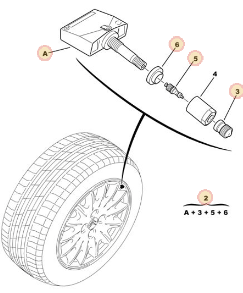

Ok David, so you have a MKI C5. This system is quite different to the subsequent TPMS units fitted.
The Mark I system consists if the Emitter on each wheel, and a High Frequency Receiver that is incorporated into the Steering Wheel Switch Module. This then passes the information received through to the Car's BSI (Main computer) via the car's VANCAR 1 network.
The BSI then compares the values received with pre-programmed limits and will then display one of the following 3 warnings onto the screen:
Have the tyres been changed recently? - Emitter could be damaged when removing / refitting the tyres
Have you noticed anything else strange happening lately, like the headlights turning off randomly, or the dash board lights / electrical accessories turning off and on, or indicators / lights randomly turning on or off?
Any of these can be a sign of a failing Comms Unit (Switch Module). If not, then I suspect one of the emitters needs replacing as the batteries are not replaceable. A Lexia or Diagbox should be able to determine which one needs replacing as it can monitor the signals from each. The emitters for your car are £112.04 inc. VAT as of today from Citroen (as they are an older type of emitter) and the part number is: (5430 02)
There's one here on the bay for £55:
http://www.ebay.co.uk/itm/GENUINE-PEUGE ... 2548.l4275
BUT - I would definitely get it diagnosed first before spending out - just to make sure. This part number also includes 3, 5 & 6 - the wheel valve plug, the Valve mechanism and the Seal
