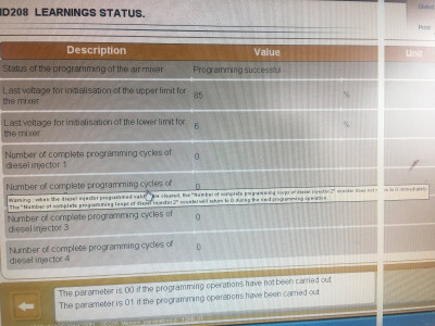

The trick is the Diagbox v7.82 (only this one can connect) has no option for calibration, injector learning, like in the old Lexia3. :rofl2: Option for only code the injectors bleed them and go home. (no figures at all just inj 1 2 3 4)

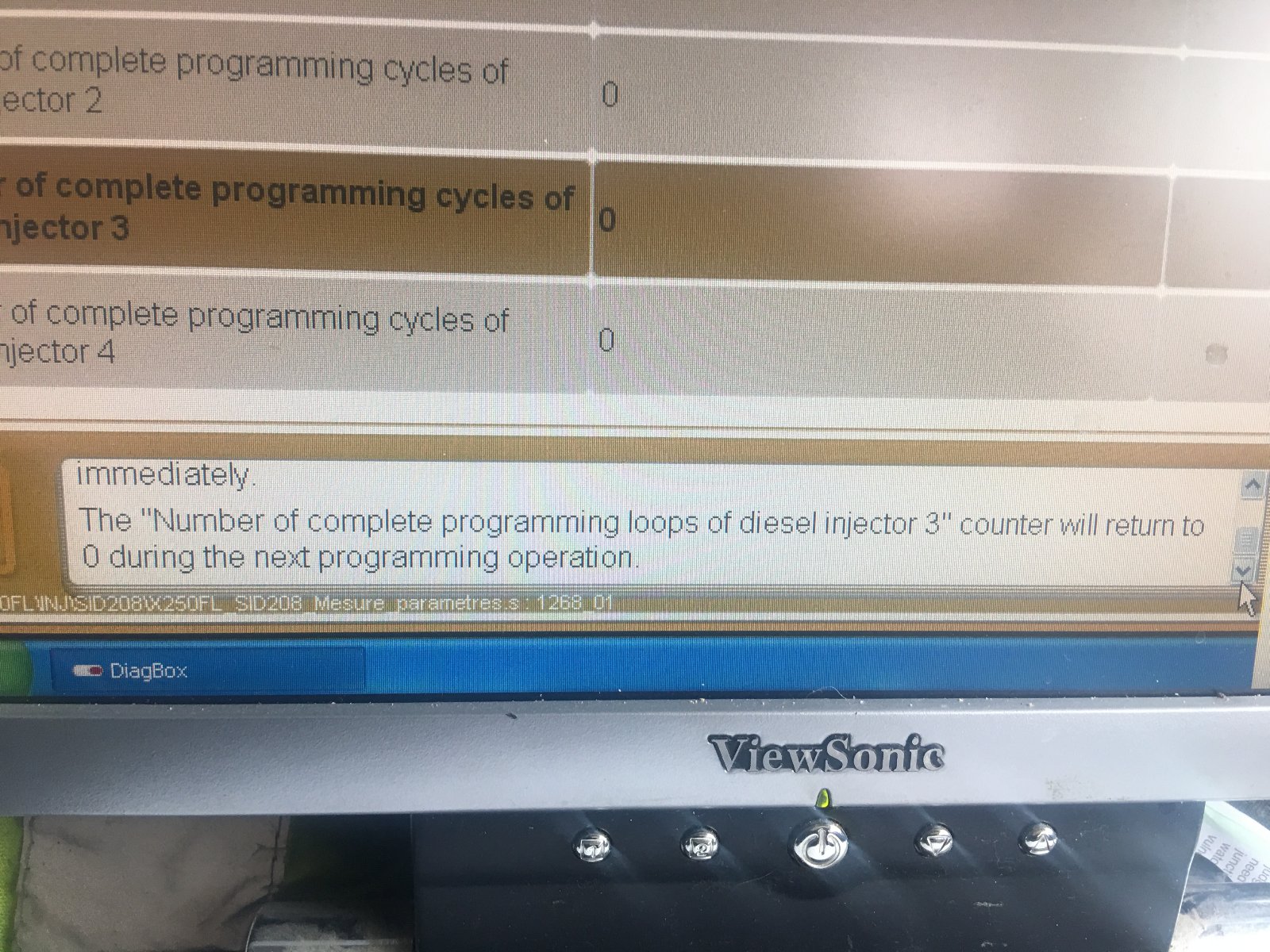

I can only read the learning status of the injectors, idleing, at 70-80C shows learning not done.
