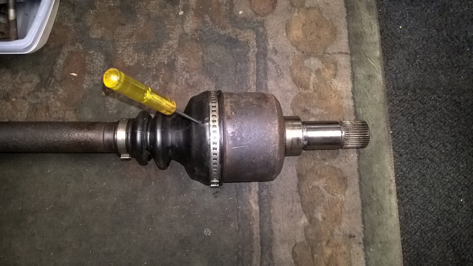

It's been a case of two (or three) steps forward and one step backwards on the Activa today...
Found the replacement CV boot is the wrong one - there's two choices as per typical Citroen - and the other side wheel bearing is not perfect. I'm going to have to replace it despite last changing it maybe two years ago.
I'd may as well whilst all is in bits... It would be niggling if all went back together and it proved to be noisy...
I know it was changed relatively recently as the circlip came out easily and did not need a cold chisel and club-hammer
Here's the split in the CV boot. It's tiny...
The correct boot is now on order... I discover the wrong CV boot I bought is for a Saxo so it'll be useful one day! Or maybe I've seen into the future and the Saxo is going to need a boot for its next MOT! Funnier things have happened to me...
I also have a wheel bearing on order...

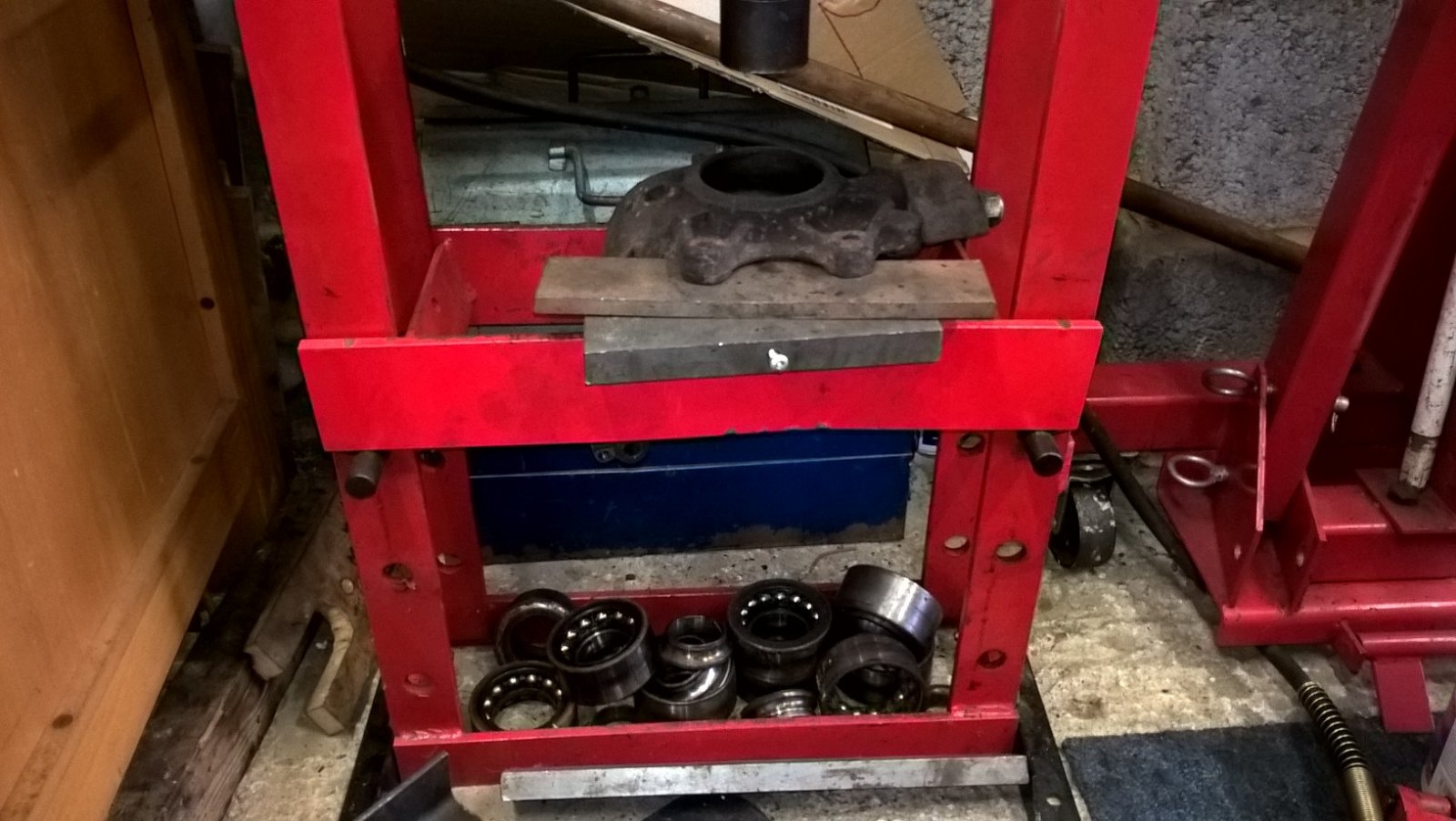

Speaking of pressing...
I've pressed out the second wheel bearing this afternoon
The base of my press really does bear silent witness to just how many wheel bearings I've done over the last couple of years or so!
When I pulled the driveshaft I naturally lost a little gearbox oil. I caught it in a clean container and measured it so that I know by how much to top up when I reinstall the shaft...
Saves a full gearbox oil change and the drained oil proves it's not needed... I lost just about half a pint...
I did another value-added job this afternoon. I unseized the handbrake cable adjustment nuts on each cable and got them running easily up and down the full lengths of the threads... It'll make setting up the handbrake with the new big calipers a nice, easy job.
