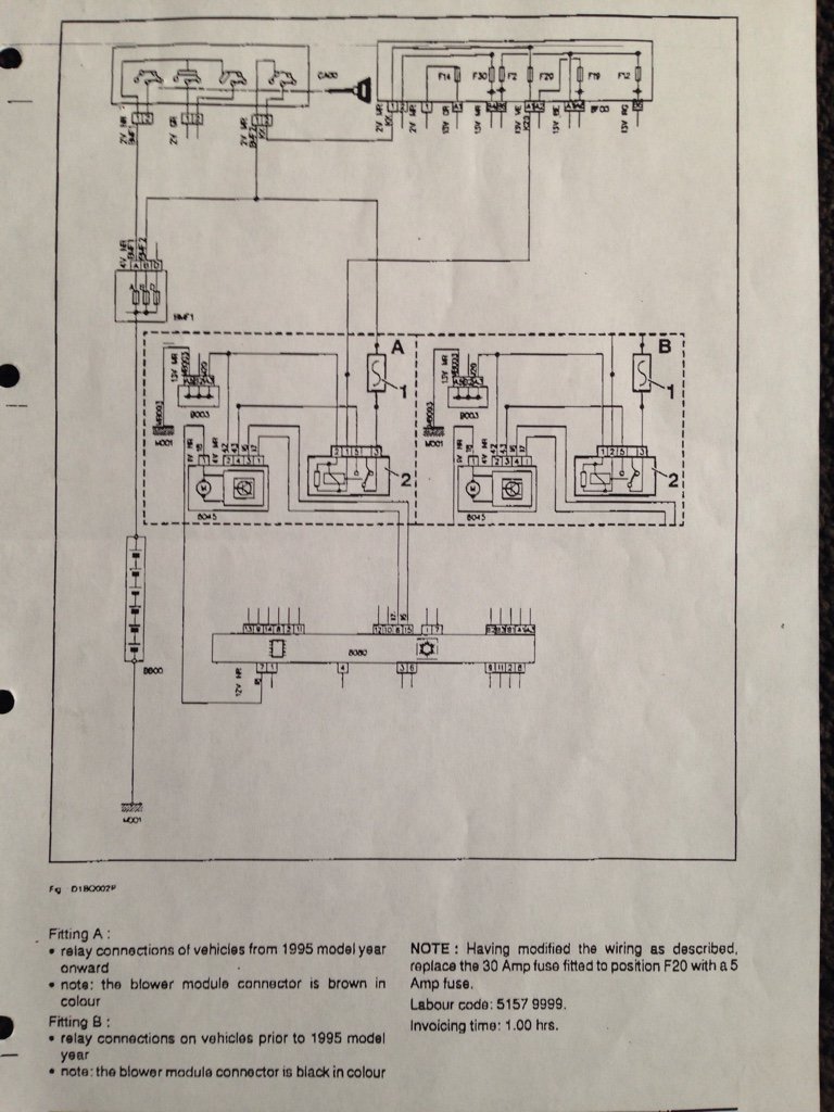

supplied official mod for Xantia series 1 wonky blower mod from a friendly user of Aussie Frogs. Hopefully this will help any future owners who encounter this sordid travesty if any still exist without the repair!

Often the switch contacts will still operate a relay, even if they won't carry enough current for the fan.
Otherwise you can drive the relay from the ignition contacts.

xantia_v6 wrote: 17 Nov 2017, 01:48 Often the switch contacts will still operate a relay, even if they won't carry enough current for the fan.
That's exactly what I did when I did this modification on my first Xantia. Instead of trying to drive the relay coil from the contact that is nearly burnt out, I got the relay coil supply from the ignition output from the switch. (One of the other two big plugs)
The only difference between them from the point of view of driving a relay is that the ignition supply is also on in the starter position while the acc contact that originally runs the fan is not. However if you have the automatic "climate control" version of the heater controls, as I did (you have a temperature scale instead of just a blue to red scale) then the climate ECU will not allow the blower fan to run until the engine is started and running normally anyway. (It monitors the output of the alternator and waits until a few seconds after it is charging before turning on the blower) So there is no risk of the fan trying to run while starting the engine.
However if you have the older manual controls I'm not sure this applies - I have never come into contact with a non climate Xantia. The manual version of the heater controls might conceivably rely entirely on the interlocking of the acc switch contact to prevent the fan running in starter mode, in which case it would allow the fan to run with the key on but engine not running. Does anyone know ?

Mandrake wrote: 17 Nov 2017, 06:43 That's exactly what I did when I did this modification on my first Xantia. Instead of trying to drive the relay coil from the contact that is nearly burnt out, I got the relay coil supply from the ignition output from the switch. (One of the other two big plugs)
So being a complete electrical dunce, this means because I can no longer get it to work using the key waggling technique that the contacts are completely burnt out and I shouldn't waste my time breaking into the wiring for the ignition switch?
This will surprise you but I do actually own a ACC Xantia (Mine has the blue to red scale) so one of the rare ones you have never seen by the sounds of it. It has a sunroof!
So where do I need to break into for the power?

CA00 Ignition Switch, power comes in from BB00 Battery via BB10 Supply Box (Engine Bay) Permanent black (NR) feed to Connector Socket 1 of a 2 channel Brown (2V MR) connector. This does not appear to be linked to a Fuse in BB10. Once the ignition is switched to M position that feeds battery voltage to Connector Socket 2 of the same 2 channel Brown (2V MR). This Connector socket is located somewhere under the steering column shrouds high up.
This feeds via a 2V MR connector on the back of the Fusebox BF00 which I cannot readily access. So there should be a 12V feed to one side of the fuse F20 (removed) when the ignition is on.
However, definitely appears to be NO voltage to this fuse! I probably need to stick a male spade connector into it so I can test properly rather than trying to force the DMM probe into the female connector.
Would I be right in thinking that if there is 100% ZERO voltage at this fuse that either the ignition switch is totally burnt out on its M position (if this is the case, how could the lights work and everything else apart from the blower and HRW?) or could it be the wire between the ignition and F20 is burnt out?
Thoughts please.
Next! Looking at Soufle image above, it looks like I would need to splice into a wire from BMF1m (Max - Fuse Box). Is BMF1 the same as BB10 because I cannot find the location of BMF1 in the workshop manual despite it being made mention of.

Roger, somewhere on this forum is some really good pictures of how to splice the relay into the loom right at the ignition switch... That makes it a lot easier to do...
I'm sure you'll find all you need to know buried in this thread and its links somewhere...
viewtopic.php?f=19&t=24786
