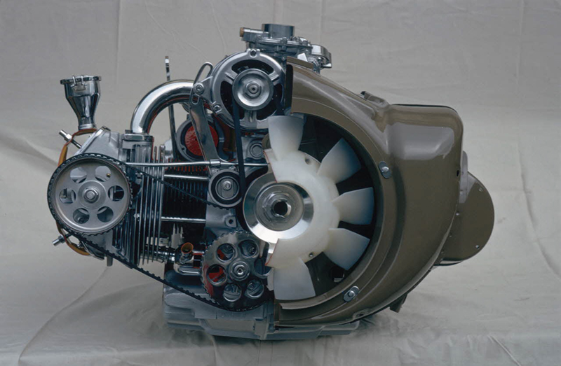

Hi my car is a 1982 Citroen GSA with 39,000 miles and I wanted to know how often the cambelt should be changed and if possible how easy is it to do please?
Any help you can give would be appreciated.
How often does a Citroen GSA require the cambelt changing?

What I can remember to get to the belts, you have to remove the front upper panel, where the bonnet catch is, the grille, headlamps and the lower front valance where the bumper is mounted, so you end up looking at the front of the engine, the Picture below gives you a rough idea of what you will see. Then once you remove the cowling, and fan you have access to the belts.
If I remember correctly, best use a lot of thread free spay (Plusgas).
