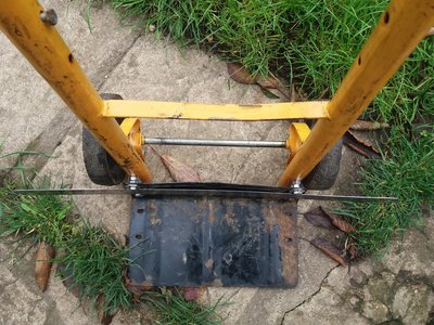

Details of this one: as usual, designed by idiots. Grr !!
Due to the front face of the wheels being approx 12mm forward of the back of the load bed, anything wider than the bed fouled them. Some spacers on new longer bolts and we were sorted.
Explanatory pic....
Also Grr, why do I so often find that manufacturers like to drill a hole that's much too big for the size of the bolt used in the fixing? Does anybody know what they're doing?!
