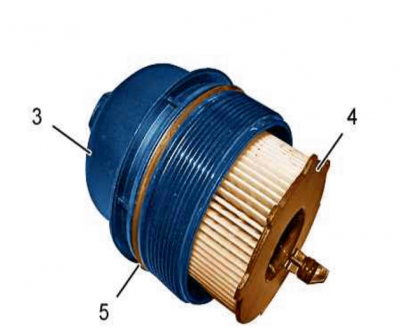

Asking for help:
Oil filter:
A) What is the size of the socket needed, to remove it.
B) Which way am I turning the cover to remove it?
C) How do I then remove the filter from the cap (Twist or just pull?)
D) Do I simply push the new filter onto the cap?
E) Correct torque when tightening cap?
F) Any tips for this job are most welcome

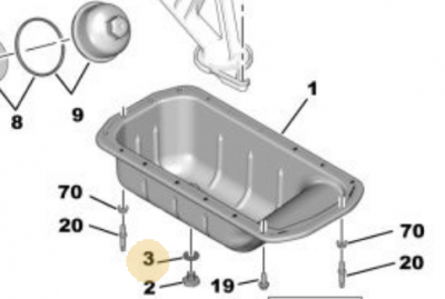

Sump Nut & Seal
1) Purchased fresh sump seal - one side is smooth and without any folds/breaks in it - the other side has a fold all the way around. Which side should be touching the sump pan when replacing?
2) What is the correct torque for tightening the sump plug?

D) You must replace the Seal (5) in the diagram and this needs to be lubricated with engine oil and use your finger to ensure it is correctly seated.

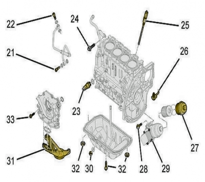

E) The torque is 2.5 daNm
Drain plug tightening is 2.5 daNm, see if you can determine fitting position from the diagram. Make sure you have a new seal too.
B) & C) Again it doesn't say.

Can i please ask you to confirm that the torque for both the sump seal & the oil cap is the same.
I.e - are they both, definitely 2.5 daNm?
Many thanks for your input.
- x 6963
Re: 1.6hdi oil change - suction method?
Yes, definitely.
| Reference | Designation | Stage | Tightening torque |
| (21) | Turbocharger lubricating pipe | Tightening | 3 daNm |
| (22) | Turbocharger lubricating pipe | Tightening | 3 daNm |
| (23) | Oil pressure switch | Tightening | 3,2 daNm |
| (24) | Dipstick | Tightening | 0,8 daNm |
| (25) | Oil level sensor | Tightening | 2,7 daNm |
| (26) | Piston skirt spray jets | Tightening | 2 daNm |
| (27) | Oil filter cover | Tightening | 2,5 daNm |
| (28) | Oil filter support | Tightening | 1 daNm |
| (29) | Coolant/oil heat exchanger | Tightening | 1 daNm |
| (30) | Drain plug | Tightening | 2,5 daNm |
| (31) | Oil suction strainer | Tightening | 1 daNm |
| (32) | Sump (Not DV6UTED4) | Tightening | 1,2 daNm |
| (33) | Oil pump assembly (*) | Pre-tighten | 0,5 daNm |
| (33) | Oil pump assembly (*) | Tightening | 0,9 daNm |
| (*) Follow the tightening sequence |

A 27mm - you need to remove the air inlet pipe, and then use a long extension. Get a decent fitting socket as it is only plastic.Andle wrote: 27 Sep 2019, 09:02
Oil filter:
B Std RH thread, so anticlockwise
C It 'just' pulls off. Wear gloves!!! There is a video on youtube where someone used a toilet roll centre as a tool to release the clips, but I've always managed to get them off with a combination of a pull and wiggle it side to side
D No. The filter has a lug on the bottom of it - fit it into the filter housing ensuring that the lug engages in the hole in the housing, then screw the lid on. It's quite tricky to get the lid started as you have to push it down onto the paper at the top of the filter element to get the threads started.
