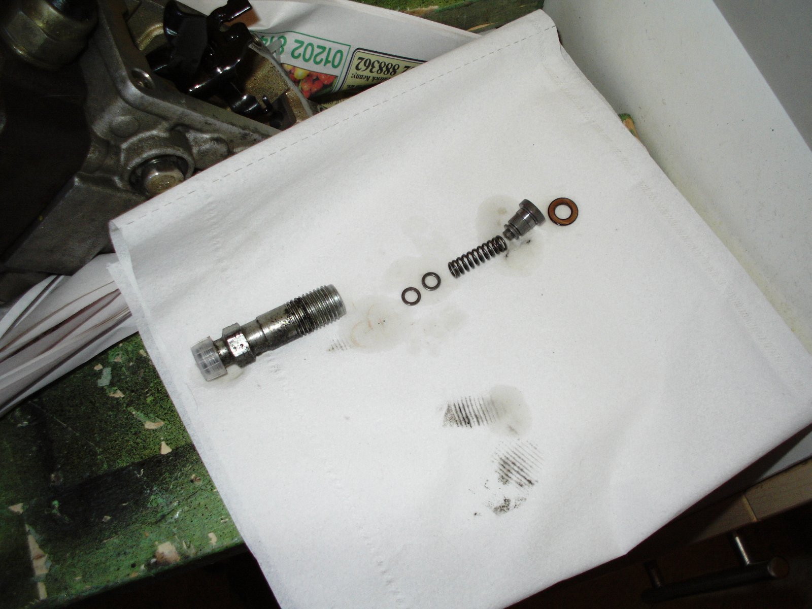

I can't recall if you've been there already but if it will help, here's one (1.9TD) I removed earlier....

Dan, your thoughts are good as all four ports on the pump should spray equally and if one is noticeably down then that's not right..
Yes, it is but more likely it's a bit of dirt in the delivery valve on the pump distributor head... Dan, these are easy to remove in-situ but take care that you don't loose the spring, copper sealing washer and pre-load shims.
With the delivery valve out, swing the engine over to allow some diesel to flow out of the now valveless port to flush any potential muck out.
I've seen the delivery valves well gummed up in the past, especially if the engine has run on veg in the past and has then sat around with old veg slowly going rancid in the pump...
MikeT wrote: 07 Sep 2017, 20:30 Is it possible dirt has got inside the pump and found it's way into blocking one of the distributor ports? Maybe worth undoing no2, dismantling, clean then re-assemble?

CitroJim wrote: 08 Sep 2017, 08:13 Dan, your thoughts are good as all four ports on the pump should spray equally and if one is noticeably down then that's not right..
That's the part I meant Jim, just forgot it's correct name, hence posted a pic.

MikeT wrote: 08 Sep 2017, 17:55CitroJim wrote: 08 Sep 2017, 08:13 Dan, your thoughts are good as all four ports on the pump should spray equally and if one is noticeably down then that's not right..
You're quite right, Jim, that's the part I meant, just forgot it's correct name, hence posted a pic.

Ugh traffic around Sandbach/Holmes Chapel and surrounding areas is utterly stuffed, just got back in and there has (from what I'm told) been an accident involving 2 lorries on the M6 resulting in everyone trying to jump off at Sandbach and skirt round the trouble... On a Friday at teatime, the results are pretty inevitably near gridlock in SE Cheshire... Head is quite achy now and I'm tired.
However i did manage earlier to remove and clean the delivery valves which made no difference to running, then swapped #2 for one off the spare pump. The very slightest of improvements but not a lot, it's now i would say idling more time on 4 than 3 cylinders but if you give it a few revs it still smokes like a train and the idle becomes lumpy for a time afterward (more 3 than 4 cylinders for a few seconds at least).
Only option to my mind now (other than spending money on a compression tester) is to fit the spare pump, with it's own #2 delivery valve back in and see if that changes things... I'll be surprised and disappointed if it doesn't, but then i was surprised and disappointed when a set of injectors didn't cure it and again when cleaning/swapping assorted delivery pipes/valves over didn't either.
