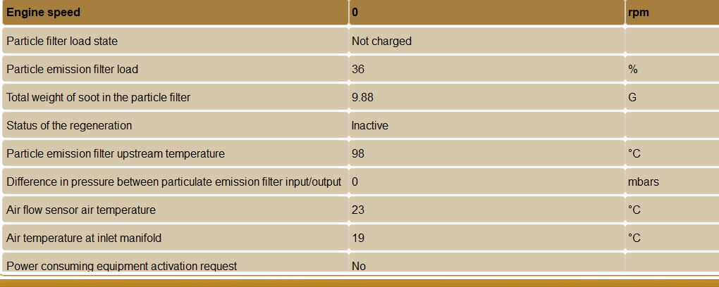

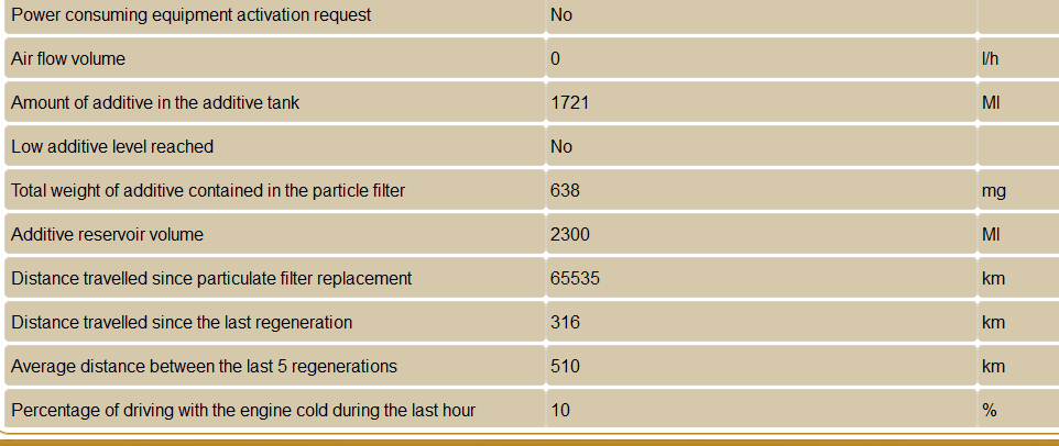

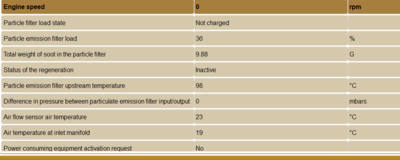

These are the screen grabs from yesterday, I think the upstream temperature sensor is broken as the car was stone cold?
From the looks of it the additive has been topped up once before.
When I started the engine I noticed about 5 mbar of pressure across the FAP which I assume is OK?

It regenned it yesterday seemingly without me noticing... up to 50% load after 150km, so it looks like it's not working that well, the car has just decided it is EOL! Was going to clean it anyway when I do the cambelt, just need to find the time and the weather to get a-round-tuit!!
EDC5 - 5mbar at idle is OK; ref the temperature it's possible that it only goes down to 100C - mine was just saying <100C

Re: 307 1.6 HDi Filter block risk
RichardW wrote: 06 Sep 2017, 21:30
That makes sense, a high temp probe probably bottoms out around 100 then
I'll keep an eye on the pressure, see if it increases long term.... I know what to do ......
