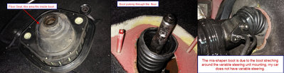

Thanks, Bobbins, I have not looked at the subframe mountings yet, but can I just lower the back end of the frame, or do I have to make provision for the whole frame to be lowered, two trolley jacks?
Looks like I have a job tomorrow, peering down a small hole in the footwell.
Thanks again, now just to find a good rack.

The whole subframe has to come down but it's actually no grief to do that. One well balanced trolley jack should suffice as there's no great weight on the subframe.
You'll be pleasantly surprised at how 'up close and personal' you can get to the pinion via the footwell - pity the same can't be said about its condition when you see it :(
It's a pity you're not closer as I've still got my old rack you could have - it'd be a good contender to send off to one of the decent reconditioners so you can swap it over without your car being off the road for any length of time.
As for reconditioners - there's plenty out there offering all sorts of promises, but - if my old pinion shaft is anything to go by - you really want one that will replace the pinion shaft. Whilst I've not used them and have no feedback on them, you might want to have a look at http://www.powerracksdirect.co.uk/Citroen-C5 as they seem to understand the need to modify the pinion seal. Unfortunately they only supply to trade / garages, so you might need a tame garage if you go down that route.

Made a slight 'mod' that hopefuly means I will not have too, placed a tie rod gaiter over the rack, Tie wrpped on then cut the over end so that the insulating rubber which fits fron inside the car sits in side and hopefully has seald the shaft from spray and whatever.
Now, the rack when mving it by hand was stiff and not it is fitted it still is, does it self beed, or is there a process I have to follow?
I followed the list of actions posted by 'Bobbins' - very helpfull.
viewtopic.php?f=3&t=57734
